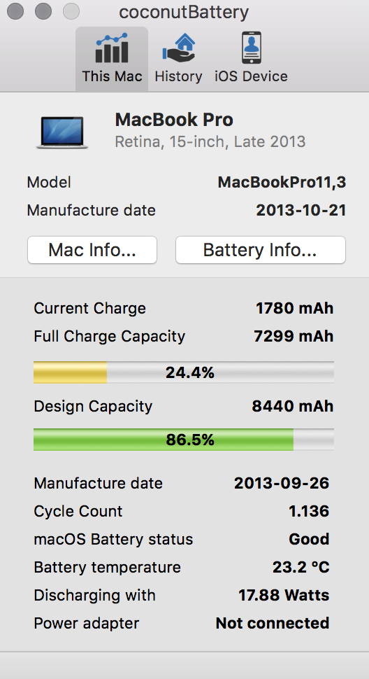

Is that cycle count 1.136 or 1,136? I was using iStat to get my info. I just downloaded coconutBattery and the cycle count uses a comma for the thousands place on my version. If you're only at 1.136 cycles, I'm really impressed. If you're at 1,136 cycles, then I got screwed on the battery because you've done more cycles than me and you've got way more health.
one thousand 136 cycles. your coconut battery uses a comma because you are from the uk or usa or other Anglo-Saxon country. Rest of the world uses a dot as thousands separator.
[doublepost=1486025777][/doublepost]but you know what, your question made me look at the screenshot again and I found out that the two lines "battery temperature" and "discharging with" are not following the system-wide region settings. There should be a comma instead of a dot, it's probably a bug. At least degrees are correctly Celsius and not Fahrenheit. Also the date format is not correct.
That makes sense. It also occurred to me, I'm on 10.9 so I had to download an older version of coconutBattery, and my version does not have any toggle for Fahrenheit/Celsius in its preferences pane. So maybe yours does and you've set it to metric measurements since you're not in the U.S.

I have 1136 cycles, my maxed out rMBP is October 2013 and as shown above battery capacity is at 86%. I never bothered to follow any guidance regarding how to use the battery, I just charge it when is down to 10-15% and mostly use it unplugged. I leave it plugged overnight and also I never shut it down, it's always on. Frankly I never cared too much about battery or usage patterns, never had a problem with this laptop.
