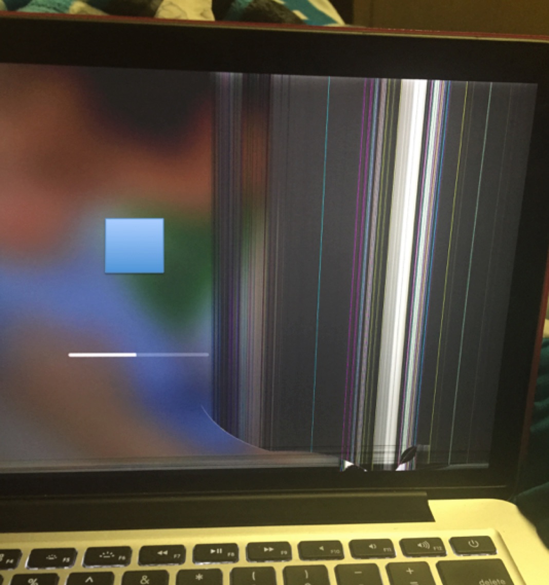

My niece sent me the attached image. As you can see, the screen is showing vertical lines on the right 1/3. She indicated that it was working properly yesterday, she closed the screen, and when she reopened it a bit later it appeared this way.
She is away at college, so I have not seen the computer myself. She said it has not been dropped. And she rebooted with no luck.
I did ask her to try plugging the laptop into her TV (she has the appropriate adapter and HDMI cable), but she was heading off to classes so will try that ASAP.
Any ideas what the issue might be? She will be taking it to an Apple store ASAP, but with the recent iPhone release, I am afraid she may not be able to get a reservation for a while.
It is a Retina MBP, 13-inch, Late 2013 model with 256gb drive an 8gb RAM.
Thanks

That is a cracked panel. The printed circuit board is located at the bottom of the display, between the hinges. It seems like the damage is also extended to either the printed circuit board or the integrated circuits...
Either way, you will have to replace the display out-of-pocket for $300~400.

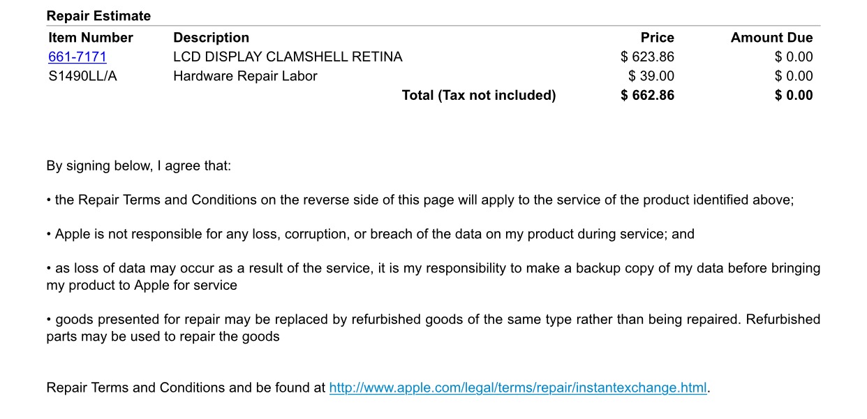

Actually...$300-$400 would be a relief...I was thinking $600-$800.

My service record is for my 15" MacBook Pro with Retina Display, Mid 2012 model.
Since your niece's laptop is a 13" model, it may be a bit cheaper.
