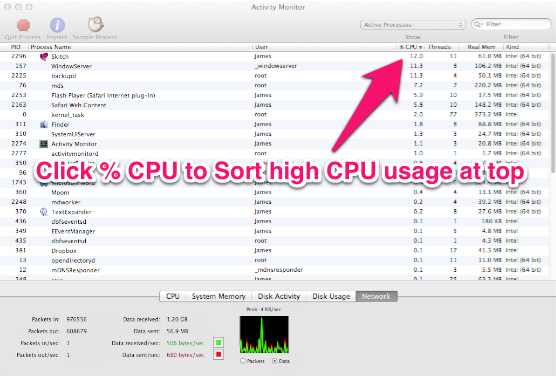

I think the first thing to try is to see if you have a process or application that is misbehaving. Something is clearly placing a load on the CPU that is preventing it from Sleeping and causing the CPU to get hot, hence the fans coming on.
Run the Activity Monitor that can be found in the Utilities folder in the Applications folder.

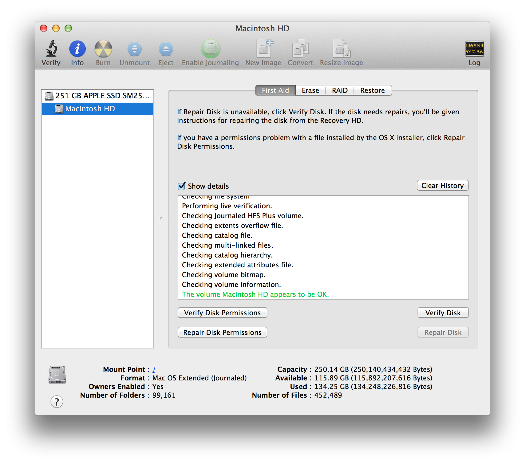

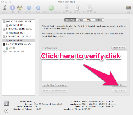

It is also worth just checking you have no disk corruption, use the Disk Utility in the same Utilities folder to verify the hard disk.
Macintosh HD1 28:10:2012 17:05.png
If the Disk Utility verification shows errors then you will need to boot from the recovery partition and run the disk utility from there to repair the hard disk.

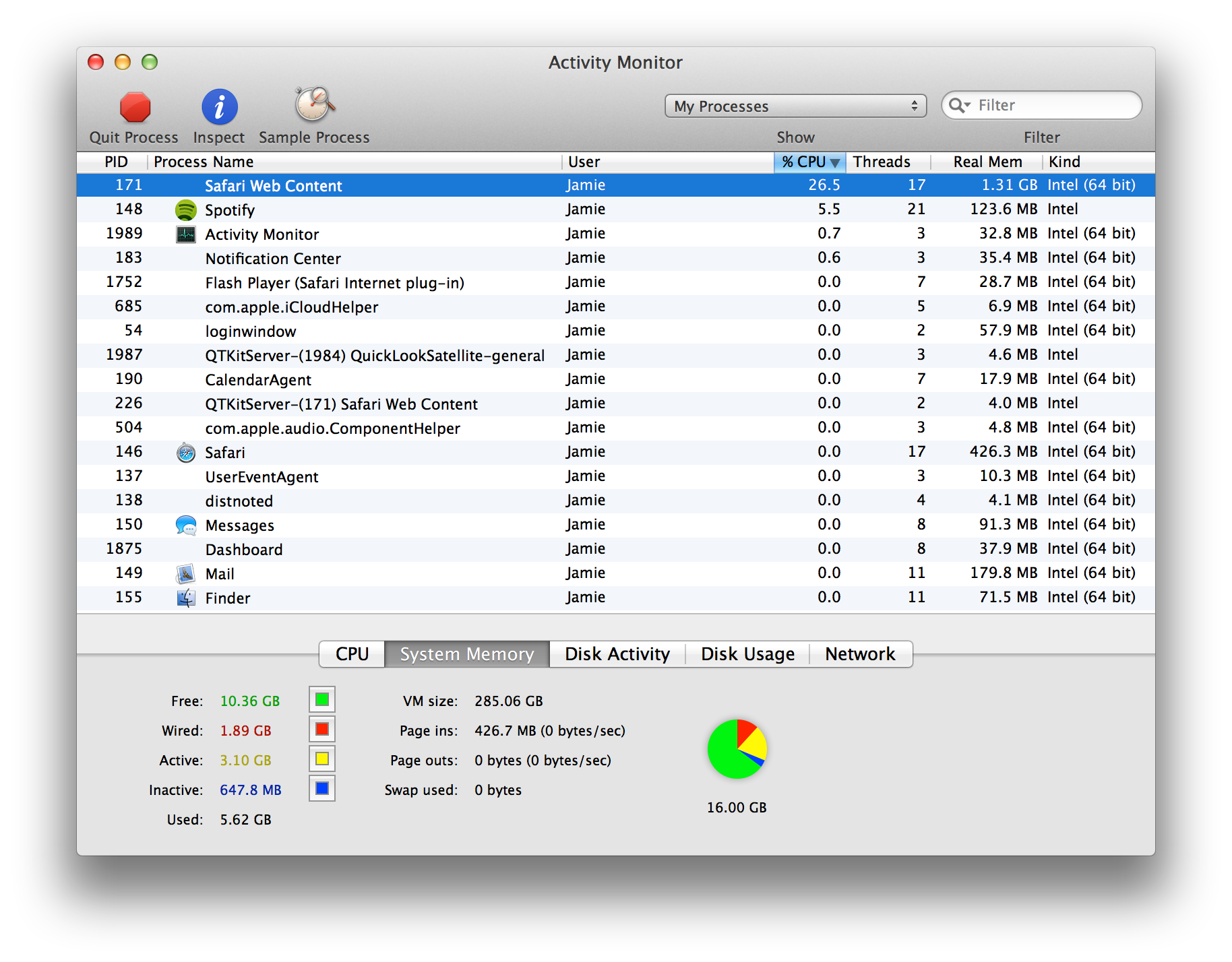

Anyway, the only programs I usually have open are Finder, Mail, Safari, Messages, and Spotify. I use Photoshop, Logic Pro, and Final Cut Pro often, but I almost always close them before closing my laptop. Even yesterday, I used Logic Pro during the day but it still slept fine. When I was using my laptop last night with casual web browsing and my other normal programs open, it didn't go to sleep properly.
Here's a screencap of my Activity Monitor. I have my normal list of programs open right now. Looks pretty normal to me? I have a nice 10GB of RAM free and the CPU seems pretty idle.
Edit: just saw your updated post, thanks for all the detail! I ran the disk check and everything came out okay.

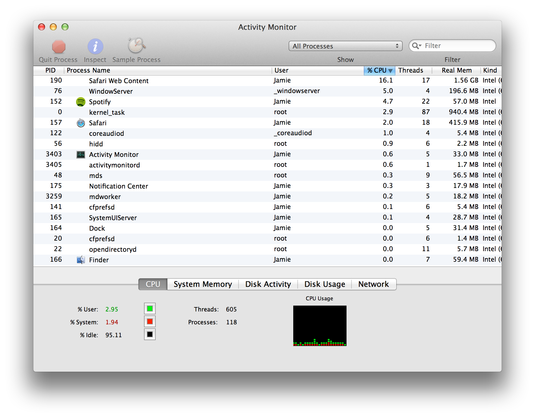

James Craner gave you good advice but if you look at processes you have to always look at ALL processes, click on the tab on top of window and select All processes.

This is what it looks like now. The percentages of CPU usage jump around quite a bit.

That's fairly normal.
I do see Safari Web content is using a bit more, I read somewhere people had problems with it before.
But it is not that high.
My advise which I gave you before still stands, I think it is better to reinstall and if you still have problems go to Apple, might be something wrong here, you could try running AHT (Apple Hardware Test) and see if there are any errors, but even if there are no errors something could still be amiss.
