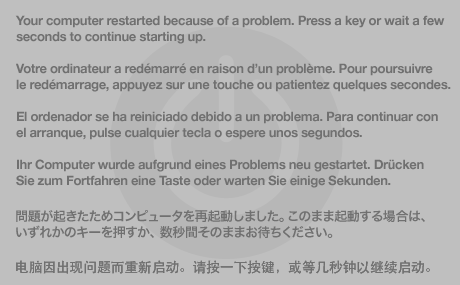

Is this screen what you are getting?
https://support.apple.com/en-us/HT200553

Nope just logs me out -close all open programs, takes me back to the login screen.
I've had my Mac Pro shutdown due to overheating it's graphics card but that was different; literally just shut down with no warning, but this isn't what's happening.
Weird huh?
