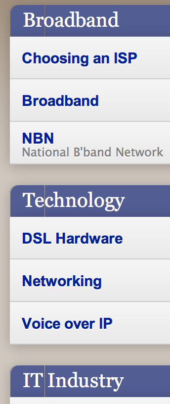

I have a new base rMBP which I have just updated to Mountain Lion (fresh install). In Safari, on some websites I am seeing a graphics issue - a white vertical line in the same spot on some websites. The line is in the same position vertically, but not horizontally. I never had this issue using Lion. I have re-installed Mountain Lion from scratch four times and even went back to Lion to verify there was no problem (but I am now back on Mountain Lion). I have also repaired permissions and reset PRAM.
This issue occurs at all resolutions, with the browser utilising the full width of desktop (but not I am not using browser in full-screen mode). I have nothing installed that could be causing this (this happens on a fresh install, nothing else installed on Mac).
If I change from integrated to discrete graphics and refresh the webpages affected, the issue disappears.
Just wondering, does anyone else have the same or similar issue?
Also, would appreciate if someone could test the Whirlpool Forums website and see if they receive the same issue in Safari on integrated graphics (see my screenshot which show the problem).

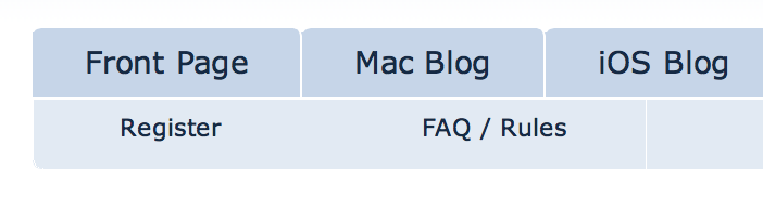

I have also uploaded a screenshot of the toolbar/navbar on MacRumors which displays the same issue (to the far right of FAQ/Rules).

I see the same issue on here (MacRumors) and the Whirlpool forums. Switching to discrete graphics makes the lines go.

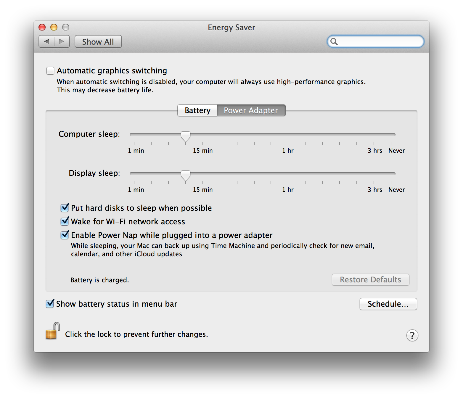

On my fresh install of ML, automatic graphics switching is enabled (under System Preferences -> Energy Saver). I have disabled it for now, restarted and both websites appears to display as it did in Lion.
Not a perfect solution, but it will do for now until I can get a chance to re-install Lion and then do an upgrade to Mountain Lion and test to see if this fixes the issue.

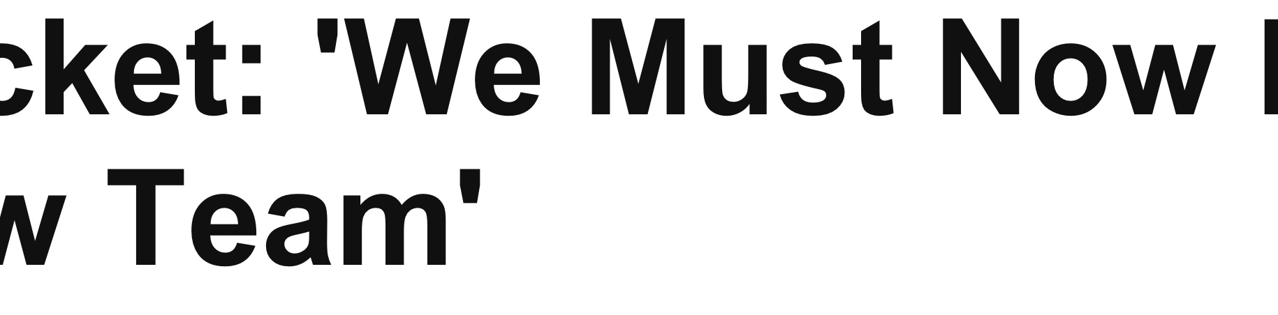

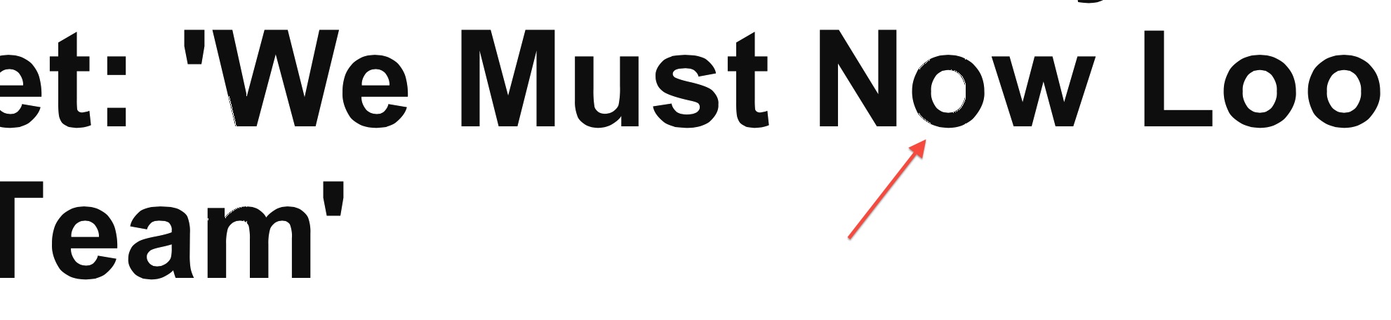

I have also noticed some odd behavior with several headlines across multiple news sites (never in the body of the story no matter how much I zoom in), but not in Chrome. See attached pics.
I'm guessing the new version of Safari has some bugs. I have never used Chrome before (I specifically downloaded it last night to check the above) and keep forgetting to use it instead; I'm pretty much a creature of habit. 🙄
Edit: the image with the red arrow is Safari. The one without is Chrome.
