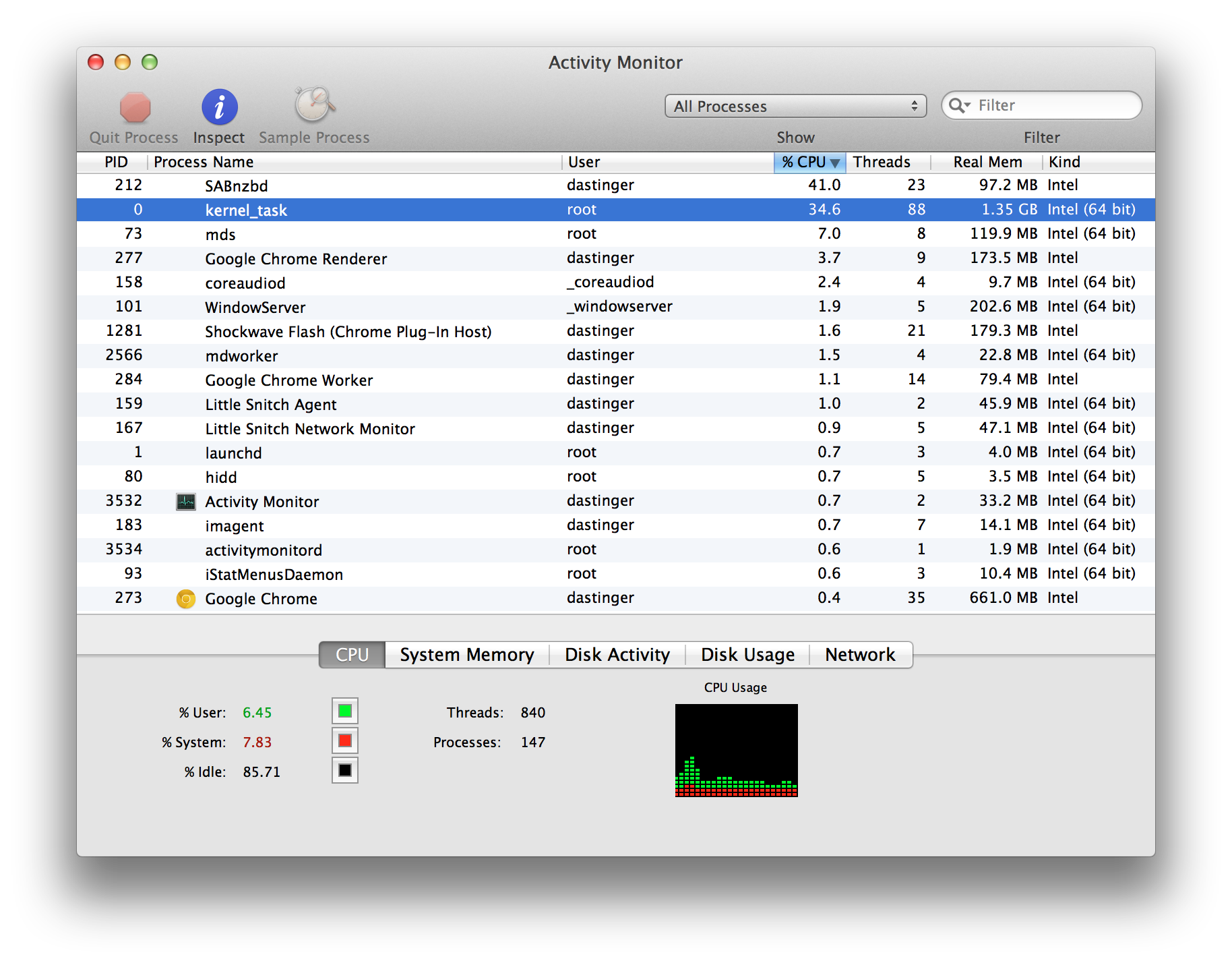

Hi,
Since I updated to 10.8.4 that my rMBP is running at constant 70ºC+ while browsing and downloading only. And temps are always going up and down.
I use Chrome Canary and, while watching a live stream, for example, the temps go as high as 95ºC. This never happened. What do you advise me to do?
Here's a screen of my Activity Monitor:
What's that kernel task that seems to be taking up a lot of memory and CPU?

The KernelTask is so large because you have third party software with kernel sharing enabled which use CPU and memory. Little Snitch is one.
I would gladly go to a genius bar but there are no Apple Stores in Portugal. I can only go to an authorized support center and hope they know what they're doing. I'm not sure that the issue is with OS X or the MBP though. Maybe it really is Flash that is just acting up. As always...
Yeh, probably it was always like that. I only noticed it now because I was looking for what could be causing the temperatures to rise this much :/
