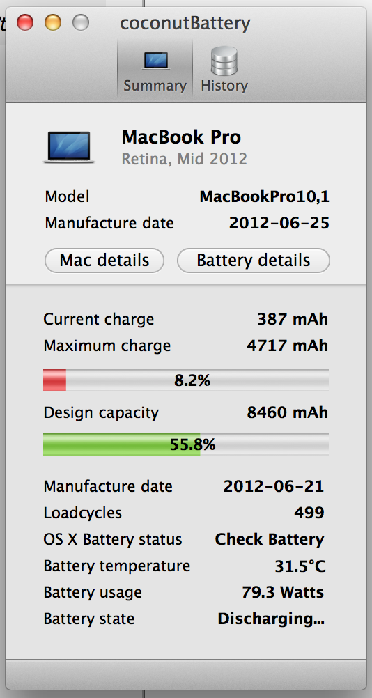

EDIT: Looks like my battery just gave out on me.

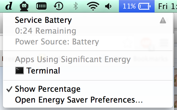

I'm well out of my warranty.
Well that's it then. I just got the error:
