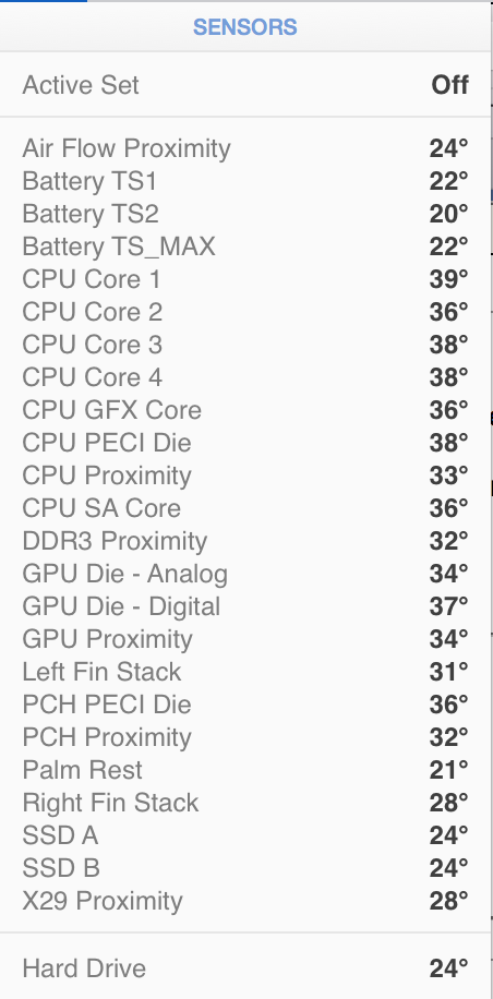

I have the app itself, and I see everything just fine.
Attaching a screenshot:
I'll give it a try then.
So it might be that I use the widget. I'll try the app instead then.
