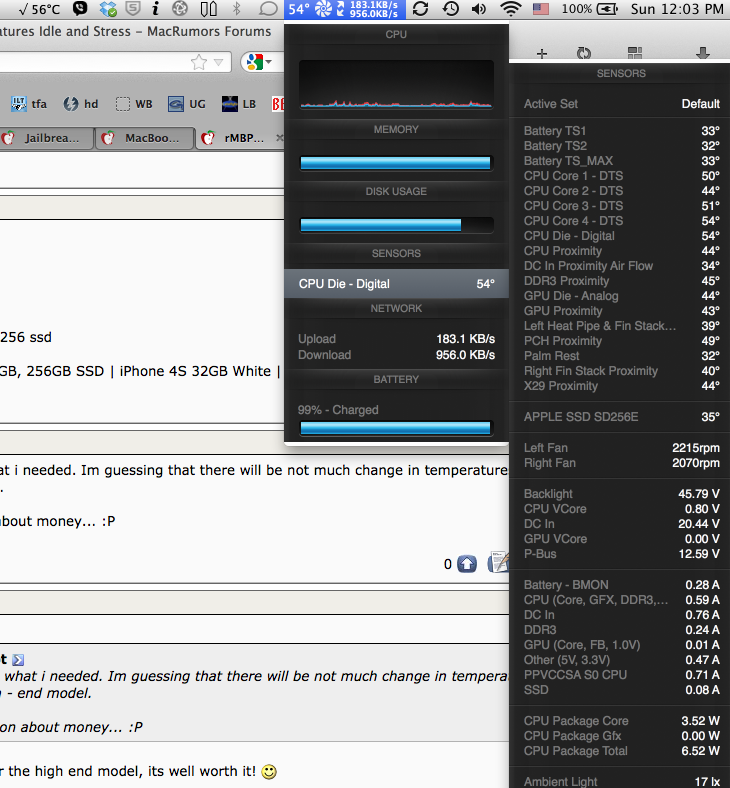

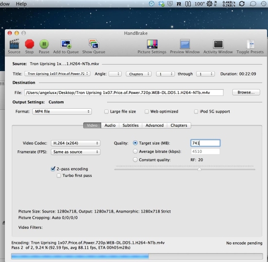

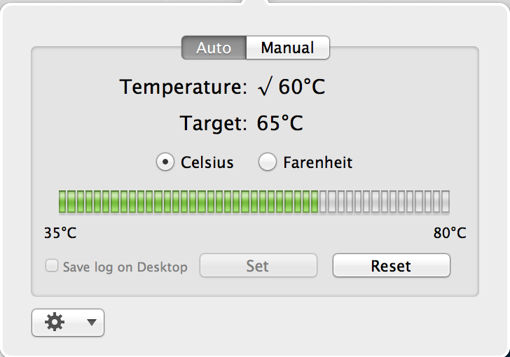

----------------------------Idle ----------------------------------------------------- Stress----------------
----------------------------------------Is my 15 rmbp temperature normal ???
