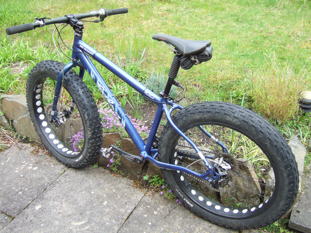

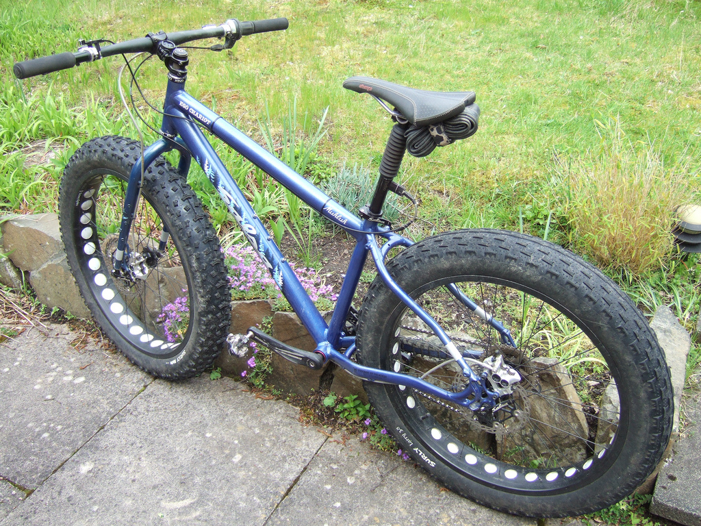

Or some sort of monster-truck style bike tyre. If it's that please take a picture 😀
My mate has got one of those...
