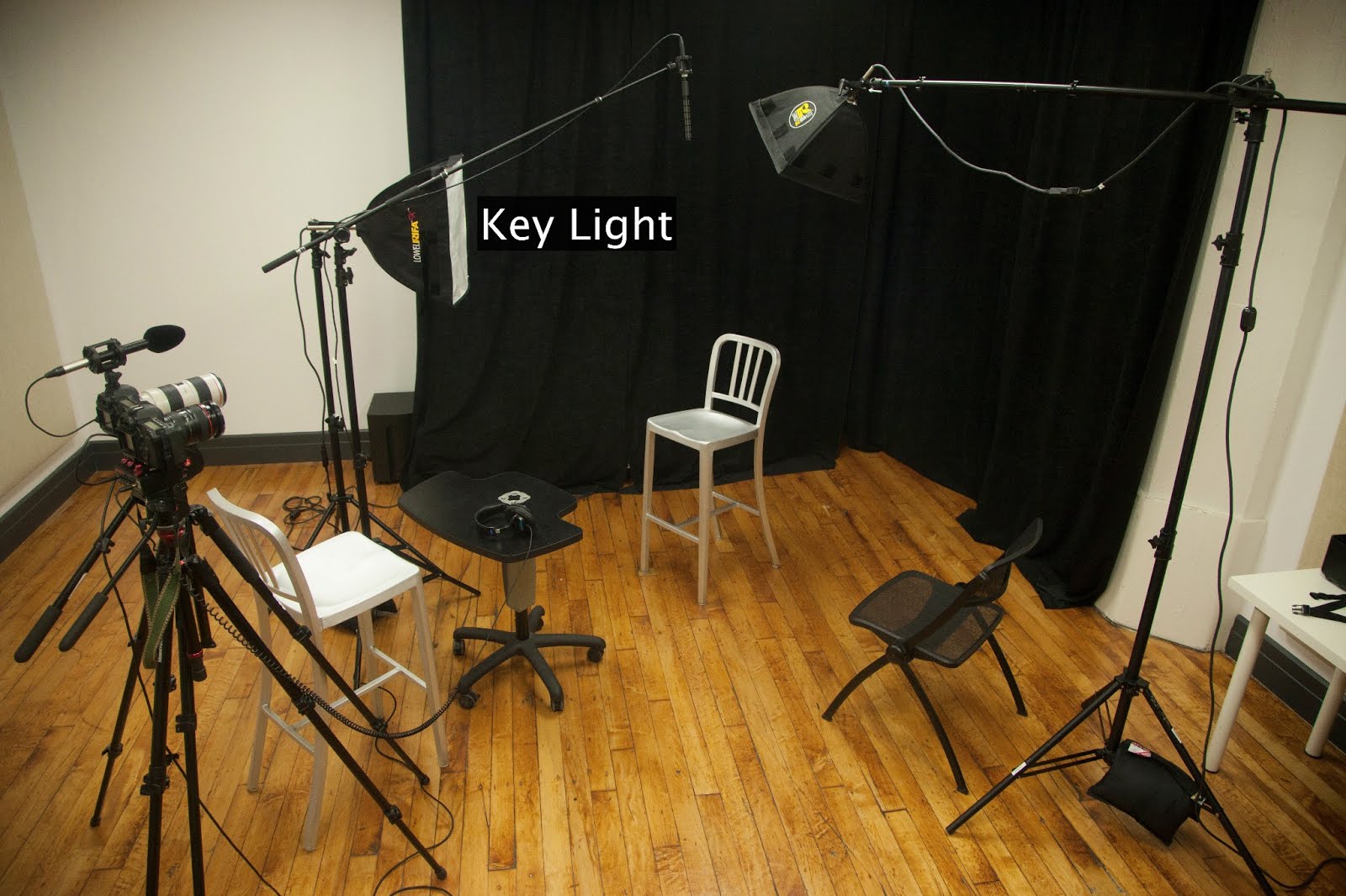

Check this out:
Notice the placement of the microphone above the subject's chair. I realize your budget is a bit limited but I would highly suggest getting a real (i.e. not a videomic) shotgun. Check out Rhode's NTG-1 or NTG-2. These are economical shotguns which means that they're not the most directional...but for indoor and relatively close-up work, that'll be fine. They also aren't the highest quality but, in my experience, they're far better than the videomic or the like.
I really have to recommend against an external recorder as the potential for that causing problems is just too great. If you really need your mic placed far away from your subject, invest in longer cables or a wireless package. Heck, I've had audio problems with recorders that were jam-synced with the camera.
Also, there are plenty of cheap boompoles out there and, for interviews, a regular mic stand will work just fine.
As a small side note, you'll notice the smaller mic on top of one of the cameras. This is a small-diaphragm condenser which will pick up a bit of the room's ambience (reverb) to create a more realistic vocal sound. Because it will be recorded as a separate channel, it can be adjusted in post against the shotgun for just the right mix.
Finally, don't forget the lights! I know that's completely off-topic...but lighting is a must especially for formal interviews.
