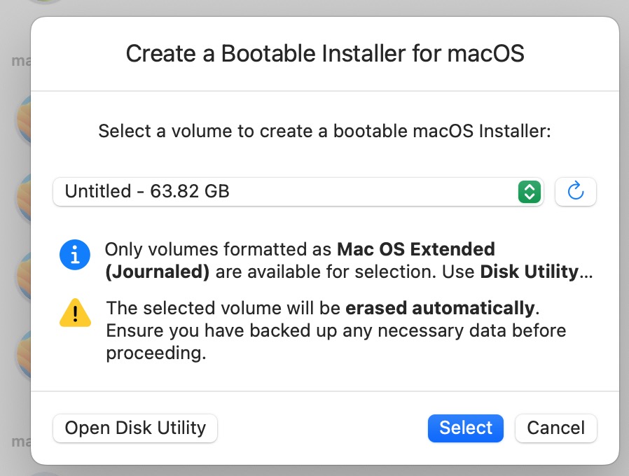

OK, launched Mist.
Looking at opening screen.
DO NOT click on firmware. (up above)
DO click on installers.
BEFORE you go further,
insert your flash drive so it's ready to select.
The flashdrive should be formatted to HFS+ (Mac OS extended with journaling enabled, GUID partition format). DO THIS NOW.
Name the disk "Untitled" (should be named by default).
Quit disk utility, you're done with it.
Now, look at the image below.
See the icon for creating a flash drive (look at the red arrow)?
CLICK IT.
Next, you will see this:
Go to popup menu and select the flashdrive (which we named Untitled, right?).
Then click "Select".
Now... just SIT BACK AND WAIT.
Mist should download the installer from Apple, then create the bootable flashdrive.
It will take a little while, so be patient. Figure 30-40 minutes. When done, you'll see checkmarks to the left of everything in the progress window, and the bootable flashdrive ought to appear on the desktop.
I can't make it any easier than this.
