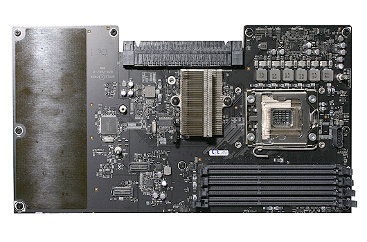

    Are we sure that the new dual processor 2010 Mac Pro uses CPUs without IHS? The reason I ask this is because the 2010 dual processor CPU tray appears to have the same CPU sockets w/ lever arm and bracket to hold the CPU in place as the single processor board. The sockets aren't "naked" like they were in the 2009 dual processor model.
    Here's the two CPU trays compared:
    2009 dual:
    [​IMG]
    2010 dual:
    [​IMG]
    2010 single:
    [​IMG]
    The CPU mounts for the 2010 dual processor match the CPU mount for the 2010 single processor. The CPU mount of the 2009 quad matches the 2010 models, which leads me to believe the new 2010 dual processor may use CPUs with integrated heat spreaders. What do you think?

    AZREOSpecialist, very interesting indeed. It looks like the new 2010 Dual board has SOCKET LATCHES!!!!! Whoa. This is really good. That means you could buy the base model 2.4GHz dual and upgrade it with X5670, X5680, or X5690 processors if you can get ahold of some for a good price. To upgrade a single processor model to a dual processor model is just not econmical. It would be cheaper to buy the full deal. But if you want those 3.33GHz or 3.46GHZ (Q4 2010) processors, then you might have a safe option upgrading these, and it might be ALOT easier with the latches on the dual processor board on the 2010 models.
    Those processors for the 2009 dual models were specialized Apple parts direct from Intel that lacked the IHS (integrated heat spreader) on top of the processors, and the heatsinks were designed to fit right on top of the processors without the IHS. Installing factory processors with IHS on them, you would risk damaging your processors if you were not careful when tightening the screws on your heatsink (Anantech screwed one of their boards doing this upgrade).
    To buy a 2.4GHz 2010 8-core model for $3499 or a couple hundred cheaper depending on what venue you go to, and then get the processors...($3100 for two X5680 is the cheapest price around I can find)....you are looking at $6599 for a 3.33GHz 12-core Mac Pro. You could also get resale value for your old quad-core processors, but you must consider a new 2.93GHz dual processor 12-core Mac Pro from Apple costs $6199.
    If you had the extra money and wanted max speed, the extra $400 for the upgrade to 3.33GHz is worth it...but I don't know what it's worth to you.
