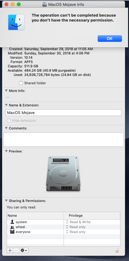

I'm trying to add myself as a user so that I'm able to make changes without having to enter the password each and every time. And basically remove that lil icon on the bottom left of each window.
Help?
Running Mojave on a 2012 Mini i7

It looks like you are trying to do this at the top-level of your drive. You realize that if you do this then you're disabling all security for your drive? You aren't supposed be able to easily write outside your home directory as then any process at all could read/write whatever it wants.
If it's a throwaway install then if you really want to do it then just disable System Integrity Protection by rebooting into recovery mode and running `csrutil disable` in a terminal. Then restart, open Terminal, and chmod the entire drive to have read/write access with `sudo chmod -R 777 /`.
Again, I completely do not recommend doing this as it's utterly stupid unless this is a VM or throwaway machine that you are just fooling around with.

It worked. Thank you.
And yes, it's my main drive that I'm doing this to. I'm the only one that uses this computer, so I know which processes I do and what apps I install.

Being the only one using the computer and knowing what apps are installed are not an excuse to run with root access. You've disabled the security established for decades. A bug or flaw could easily delete files or directories that normally wouldn't be affected. You can already access any file on the drive by using terminal and using 'sudo' which temporarily elevates your permission, but with a password. This also means that were someone able to obtain access to your system they have complete control without having to authenticate before altering sensitive files.
