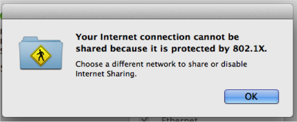

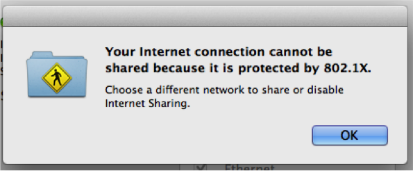

No restrictions are set but I tried bridging (internet sharing) on the Mac Mini again and got this:
Your Internet connection cannot be shared because it is protected by 802.1X.
See attached screen shot. So I think my original premise may be right in that if the WiFi is 802.1x (WPA2 Enterprise) it can't bridge (or share) the connections.
