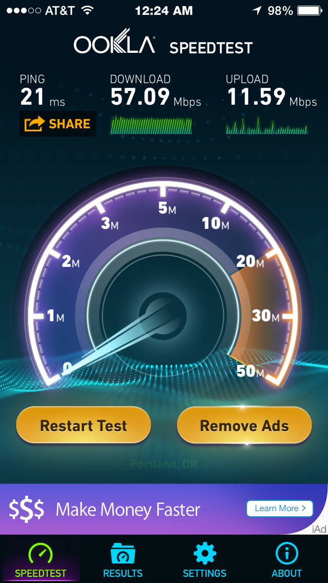

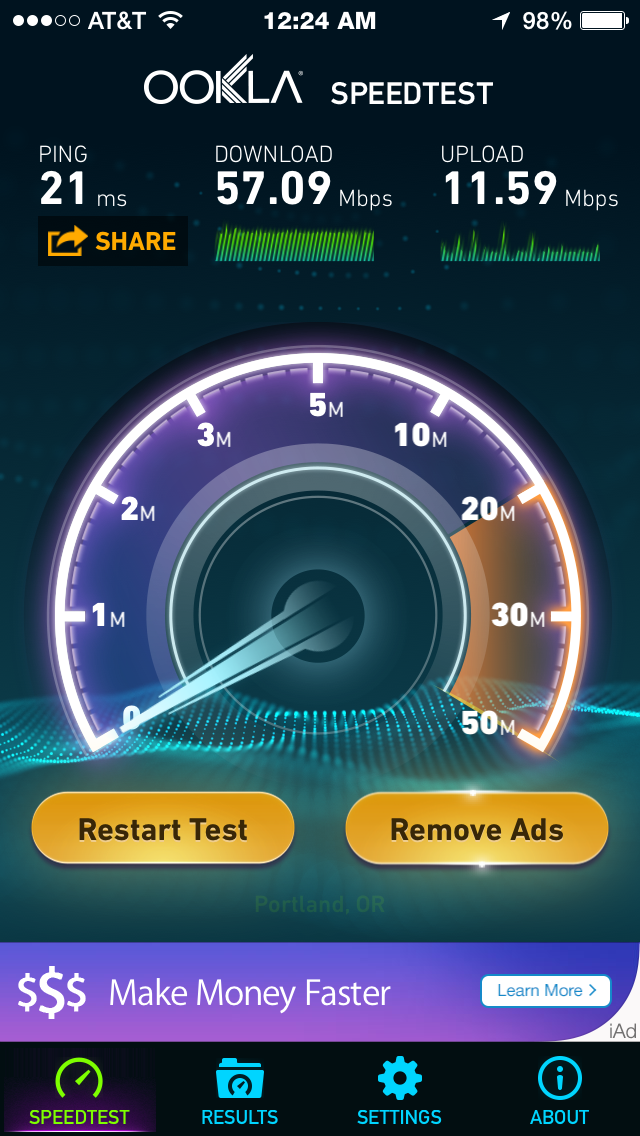

Out of curiosity I ran a speedtest on my iPhone 5S connected to the TC 5Ghz network.
Uploads were a bit slower than usual but as you can see my speeds are fine.

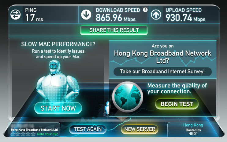

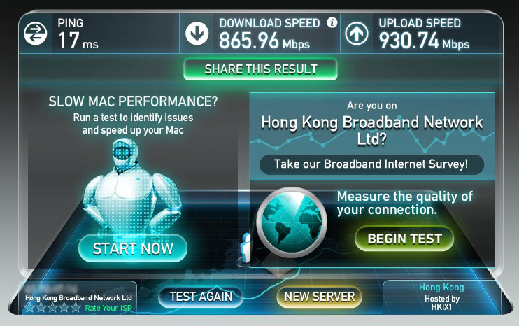

Yes, the 2.4GHz network is the bottleneck. I just run a test in my place.
My Mac Pro with the wired network to the 6th gen Time Capsule.

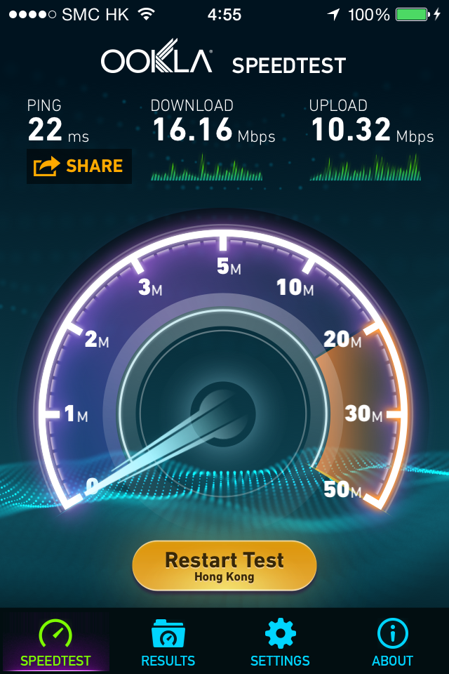

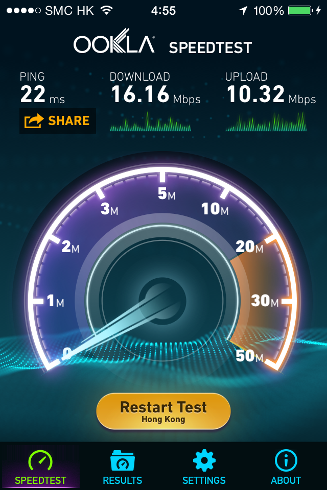

The 802.11n 2.4GHz single band speed on my iPhone 4 connect to the same Time Capsule.

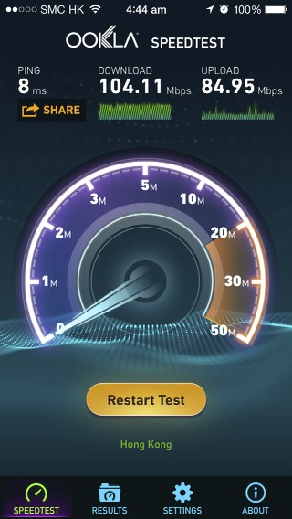

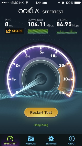

My wife's iPhone 5s connect to the same Time Capsule with 802.11n 5GHz dual band.
I don't have any 802.11ac equipment yet, so can't test it. Anyway, the ac router won't increase the max speed of your 2011 MBP (just like my iPhone 4).
