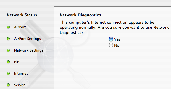

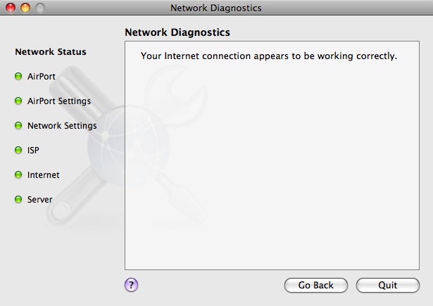

run network diagnostics and post a picture here so we can help you please
I ran the network diagnostic and everything seemed fine. I have uploaded the screen shot anyway. However, I ran the network diagnostics when I was not watching a video...I'll try rerunning it during a video commercial.

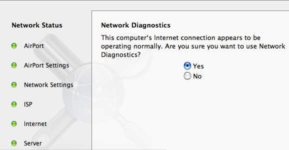

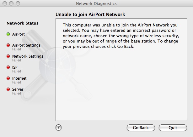

So I ran the network diagnostics after the router crashed... all I had to do to make it crash was attempt to watch a commercial on Hulu. I took a screen shot of the diagnostic page that said the computer was unable to join the network. But, it makes sense that the comp was unable to join the network because the router crashed. Another computer (a PC) that is connected via ethernet to this router also loses signal...so it doesn't only lose its wireless signal. After it crashes I have to reset the router (unplug and replug it in) and the wireless comes back on.

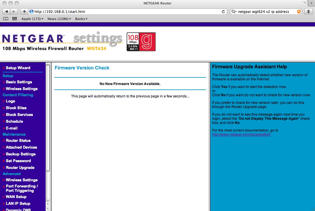

Here is the screenshot of what I received when I tried to update the firmware
