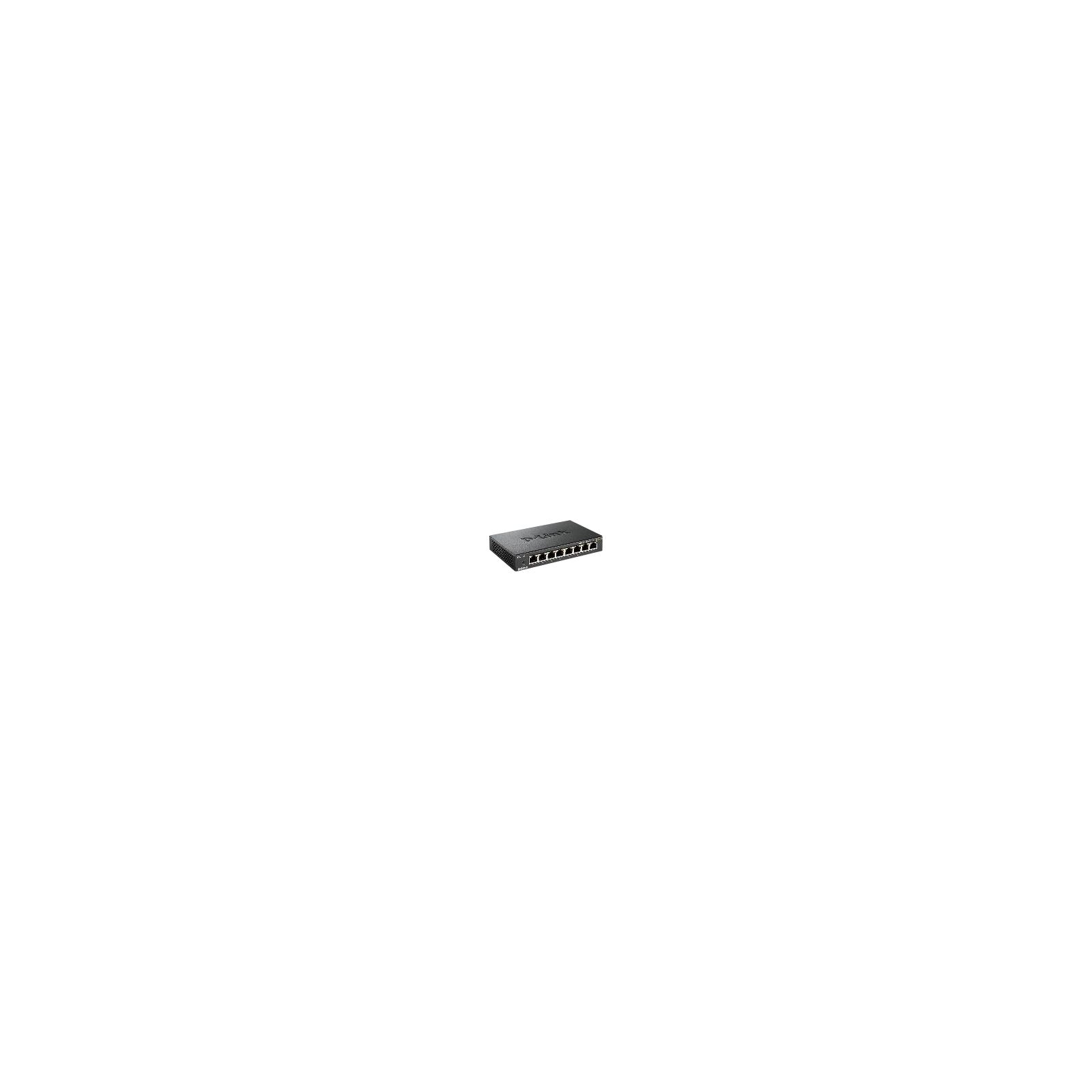

I have two of these, and I'm really happy with them:
D-Link DGS-108
Cheap, no heat (<5 watt power consumption, around 1 watt at idle), fast and made how they should be made: boring black steel boxes.
The lights indicate the actual speed on each cable: orange is 100mbit, green is gigabit. The controller can handle 8Gbit at the same time: each pair running 2gbit full duplex at the same time. It also does run fine on most crap cheap cables I throw at it. No cat 6 needed for gigabit. Even plain Cat5 often works at full speed.
10GB MKV's are transported through the house in about 2 minutes.
