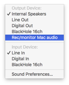

I don't know why you're thinking that Soundflower is complex. All it does is add two inputs and two outputs ("Soundflower (2ch)" and "Soundflower (64ch)") to the Mac. I'm pretty sure the other software mentioned behaves in a similar manner.
In my case, if I want to record whatever is normally coming out of the speakers I switch my system sound output to "Soundflower (2ch)" and use Audacity to record that sound by setting the input of Audacity to "Soundflower (2ch)".
Of course, you won't hear the sound being played since it's not being routed to your speakers! If you want to hear it while you record, in the "Audio MIDI Setup" app create a "Multi-Output Device" and add both Soundflower (2ch) and your normal system audio out. Select the new Multi-Output Device as your audio out and you should hear it and it will be routed to Soundflower (2ch).

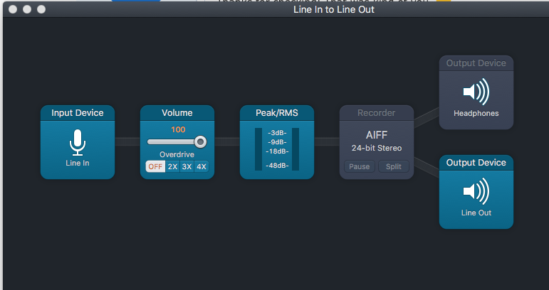

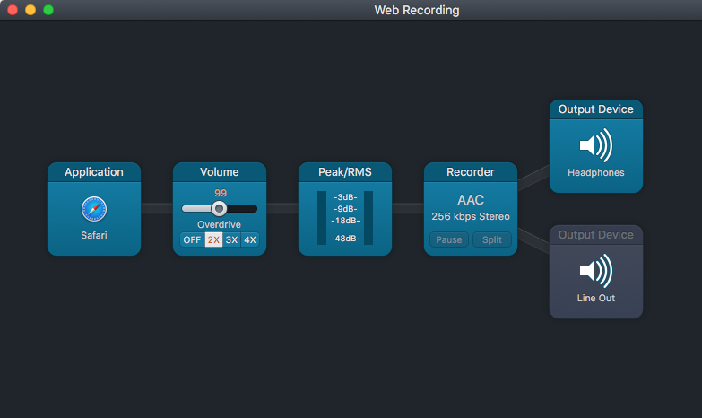

I have included three screenshots of different setups I made with Hijack and Loopback, the two images with the dark background were made with Audio Hijack.
The first setup uses Line In as the input device. The source for the Line In is the Line Out of a Sonos Connect. This setup allows me to adjust the volume, meter for proper signal level and optionally record to many different audio formats. one can even record simultaneously in different formats (not shown in this setup). The output can go to either the headphones or the speakers connected to the Line Out of my Mac Pro. Both output devices can be on at the same time if needed.
The second example is similar to the first except that it uses Safari as the audio source to record audio from Youtube or any URL.

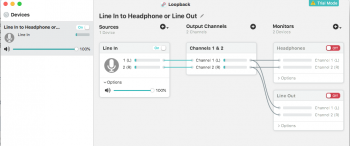

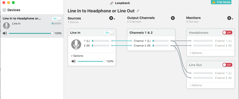

The third setup on the light background uses Loopback and routes the audio from my Sonos Line Out to Line In to either my headphone or the B & O speakers attached to my Mac's Line Out. Loopback does not have metering, recording or session capability. Additional channel pairs could be added to accommodate another sound source e.g. microphone for voiceover which would also route to the output devices.
