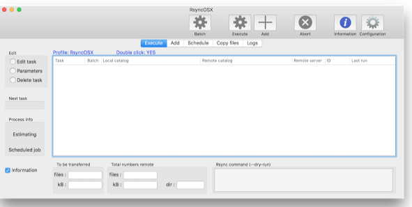

i have tried to use rsync and have come up zilch ! 1st I download it as per instructions, then I get a format that does nothing, Note "Labels" below. Also should I place "Partition's in the remote HD I'm planning to save my files in ?
I have absolutely ran aground on this rsync.

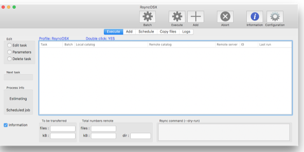

A command like this in Terminal will do fine.
Code:
rsync -avP /path/to/file/to/sync username@192.168.0.100:directory/to/save/to/
This syncs/copies the file sync to the username's directory/to/save/to/ in their home directory using ssh at the IP of 192.168.0.100. You need to turn ssh on in System Preferences -> Sharing -> Remote Login on the target machine.
