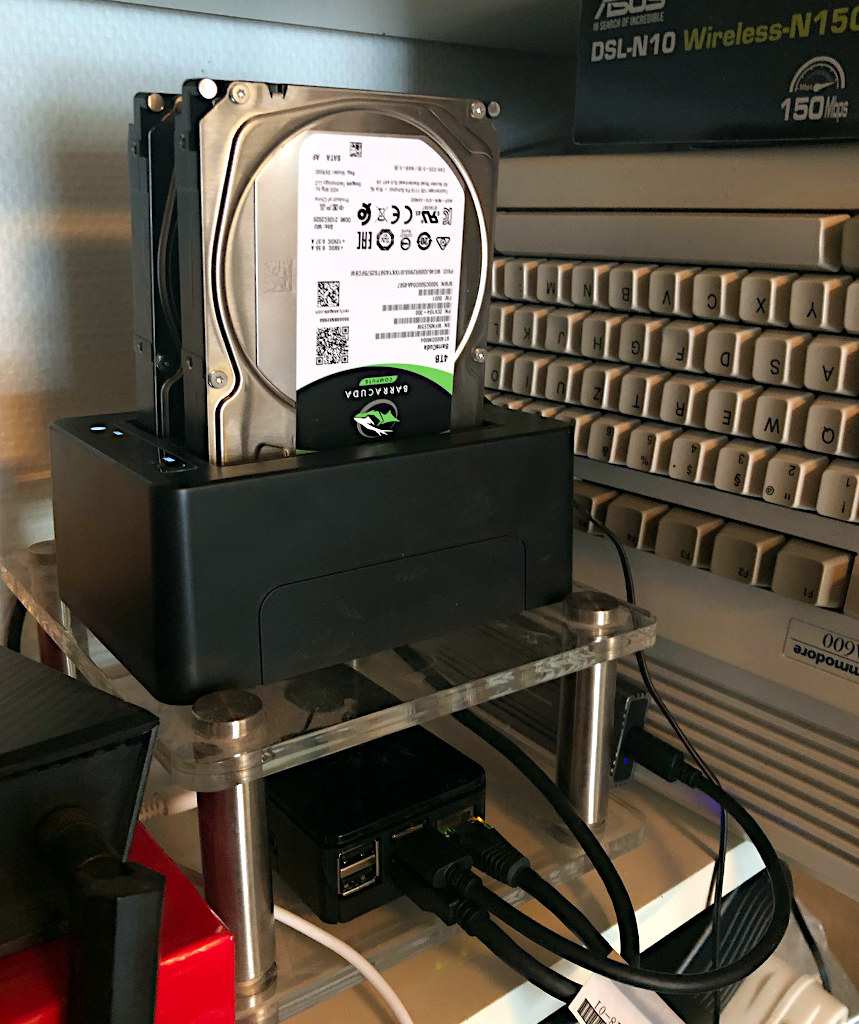

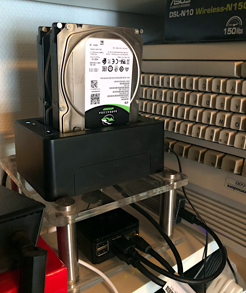

BTW. I did run a RPi 4B server with Docker, Portainer, Pihole, Shell in a box etc. -server before. I then swapped the file services to the Mac Mini 2012 about a year ago. Found the RPi option tedious to maintain and too difficult to my wife to use (so she didn't use it at all). Here it is, booting running the server software from the external NVMe + mirrored data disks on the USB3 -dock.
