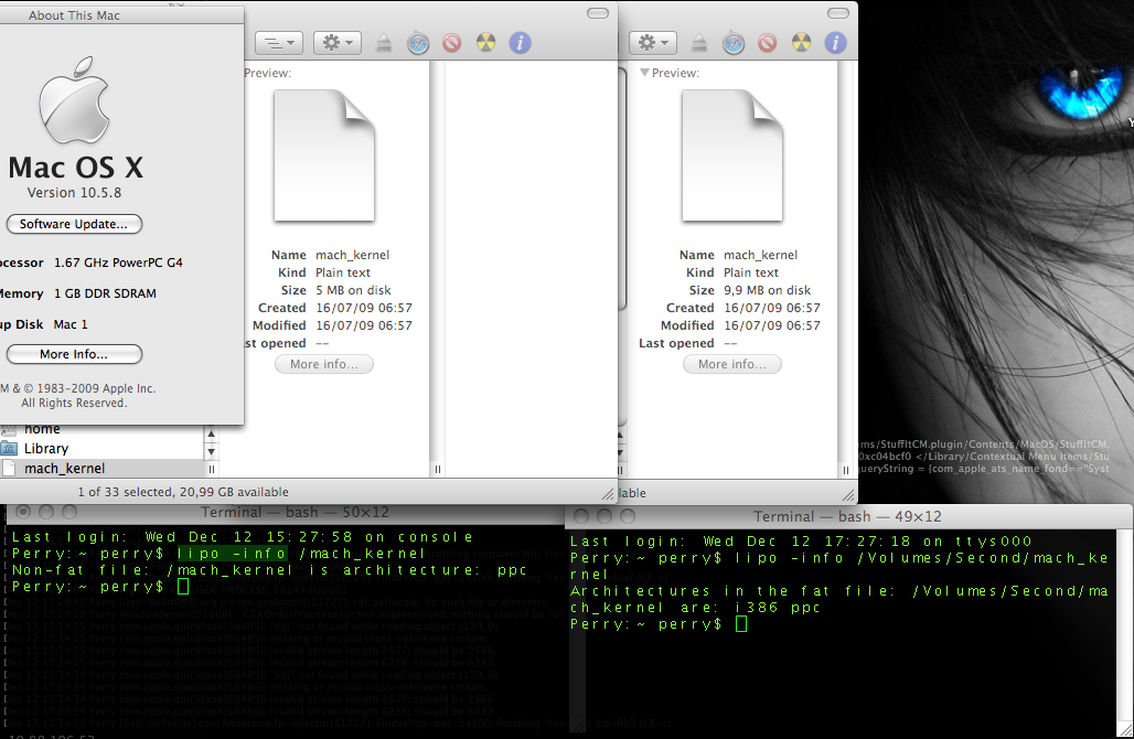

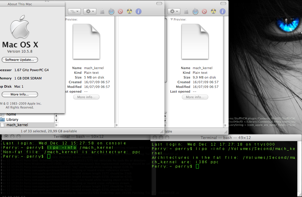

Nonsense, see screenshot, mine is PPC only, actually whole my system is PPC only.
You can strip the code of everything with a simple: sudo ditto --rsrc --arch (architecture to keep)ppc In my case PPC.
Left is a stripped kernel in Leopard(Boot Volume), right is a clean kernel in Leopard.(5 MB v 9.9 MB)
To the OP, if you completely strip ALL Intel code it will NOT boot on Intel.
