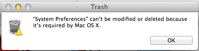

Running as non-admin should add an authentication step when deleting standard installed-with-the-OS programs.
How many times have people come here and posted "I accidentally deleted my System Preferences? Where do I get a replacement?".
All default (installed-with-the-OS) apps can't be modified or deleted. The user isn't even asked to authenticate.
The apps can still be modified if you "Show package contents" of the application bundle and make changes to the files within the bundle. You will be prompted for password authentication to complete the changes.
I believe this started with Lion? In SL, these apps could be modified or deleted with password authentication.
Mac App Store apps require password authentication to modify and delete since the introduction of the Mac App Store.
