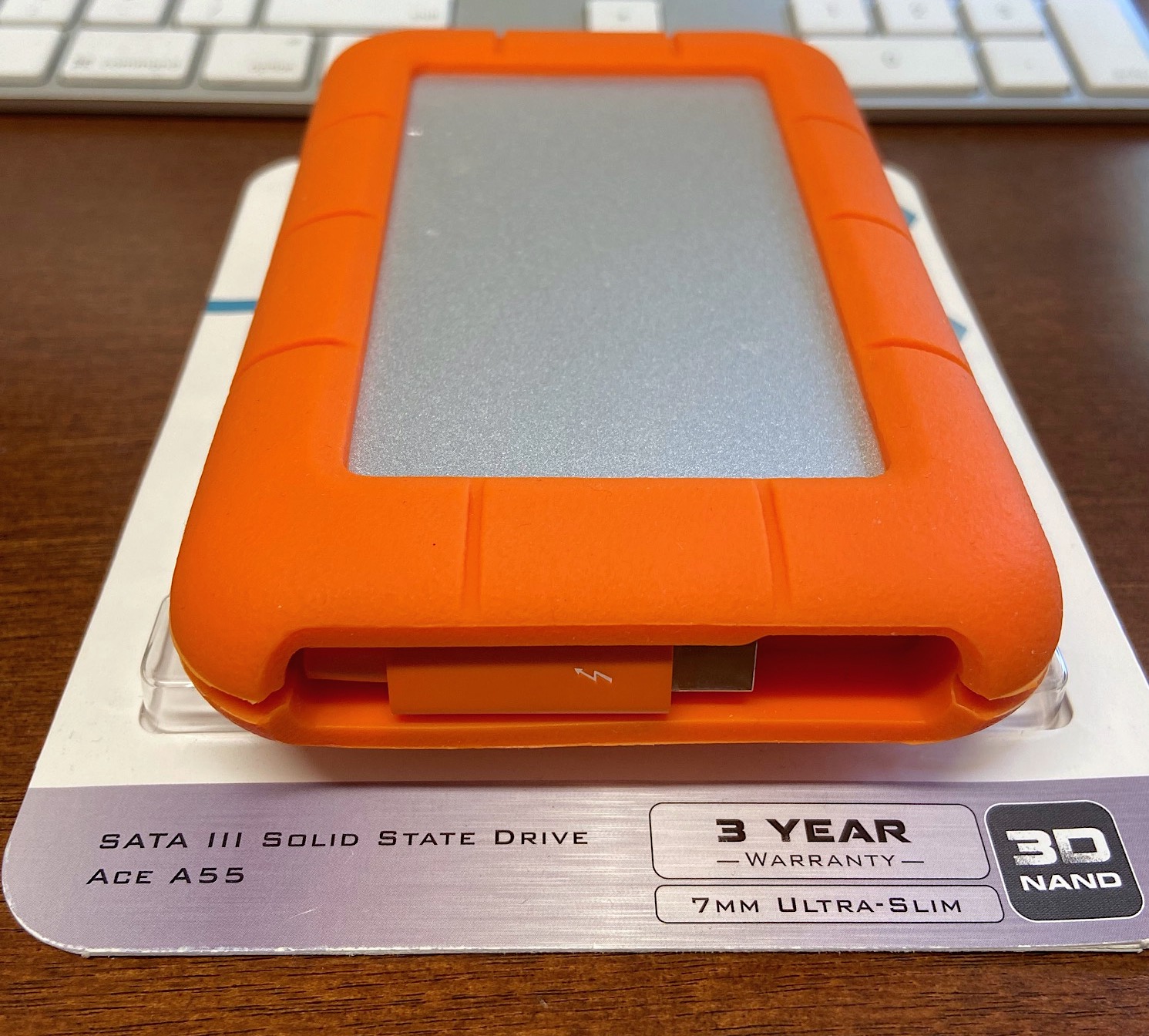

I am cheap & old fashioned so I use the old TB2 SSD 1TB external LaCie drives to shuttle between devices since I have tons of them.
Works with all my older as well as current machines: 2015 12" rMB, 2015 15" MBP, 2018 Mac Mini, M1 Mini (traded in), 2017 iMac 4K, and my current Mac Studio Max base w/ TB3-TB2 adapter.
