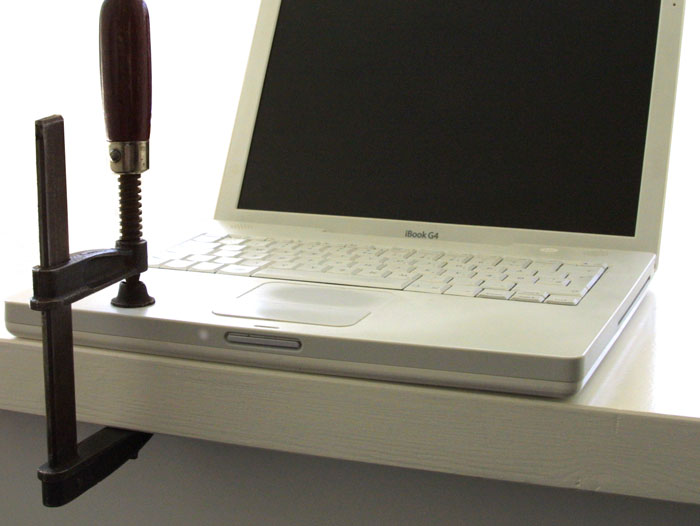

Do something similar 😀
It also slows down thiefs when they are trying to steal your server and prevents you accidentally knocking it down from table etc. 🙄
But yes, solder joints would need to be rejoined for the machine to be reliable, which I assume is very important for a server.
Clamping down an iBook like that is a very very bad idea. That is where the hard drive is and if you clamp it too hard you can crush the hard drive.
