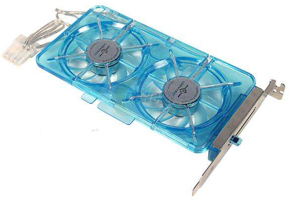

This fan by Vantec makes my 3,1 cooler!😎
