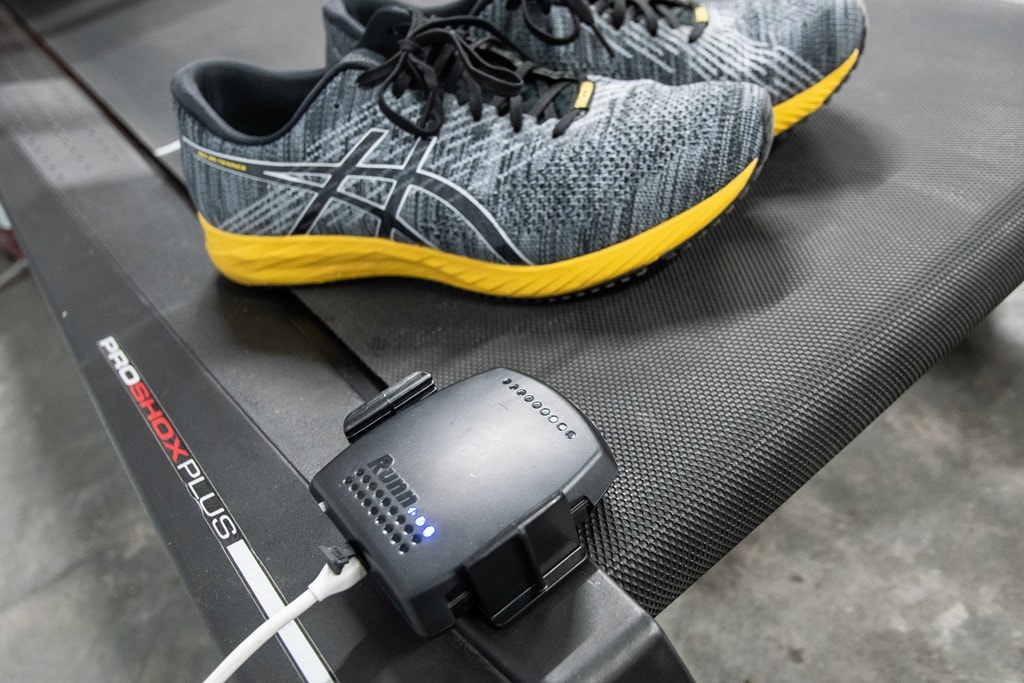

There is also this Runn device that is mounted under the treadmill. Read good reviews about it.

I'd recommend you have a look at the Runn-sensor also. Checked the price and it is far cheaper than I thought. If you have your own treadmill, this could be a very good solution.
Runn Sensor is now also a Zwift product:

I use the NPE Runn with my Garmin and it’s terrific. They also have an Apple Watch app but I haven’t tried it. I prefer it to using a footpod because it’s accurate at any pace. My Stryd never was.
