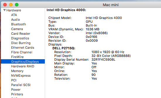

Running at 60Hz, over DP and HDMI - cropped screen shot attached. My Mini on my desk (we have 5 in our office) has 16GB RAM so there's a bit more RAM for the integrated video to feast on. No lag whatsoever. I'm only connected to the HDMI port for my convenience - the Mini is not my main Mac, and I want access to the TB port for file transfers.
