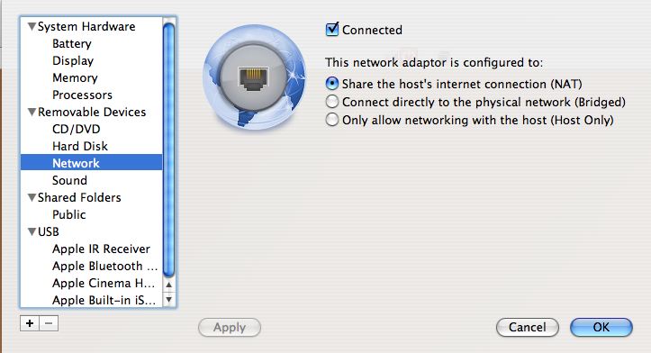

Networking...
The network option for the IP address is very straightforward, as below:
Windows will either get an address from a DHCP server, a virtualized IP address, or share your computers IP address depending on which option you check in the settings.
