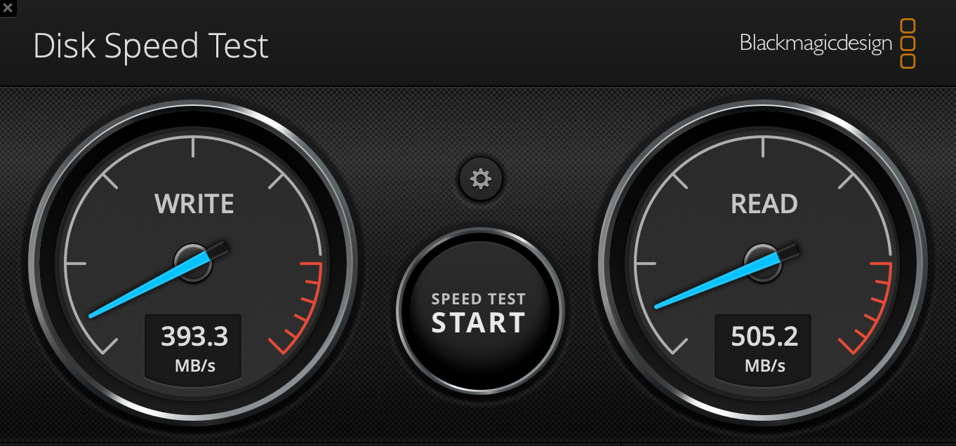

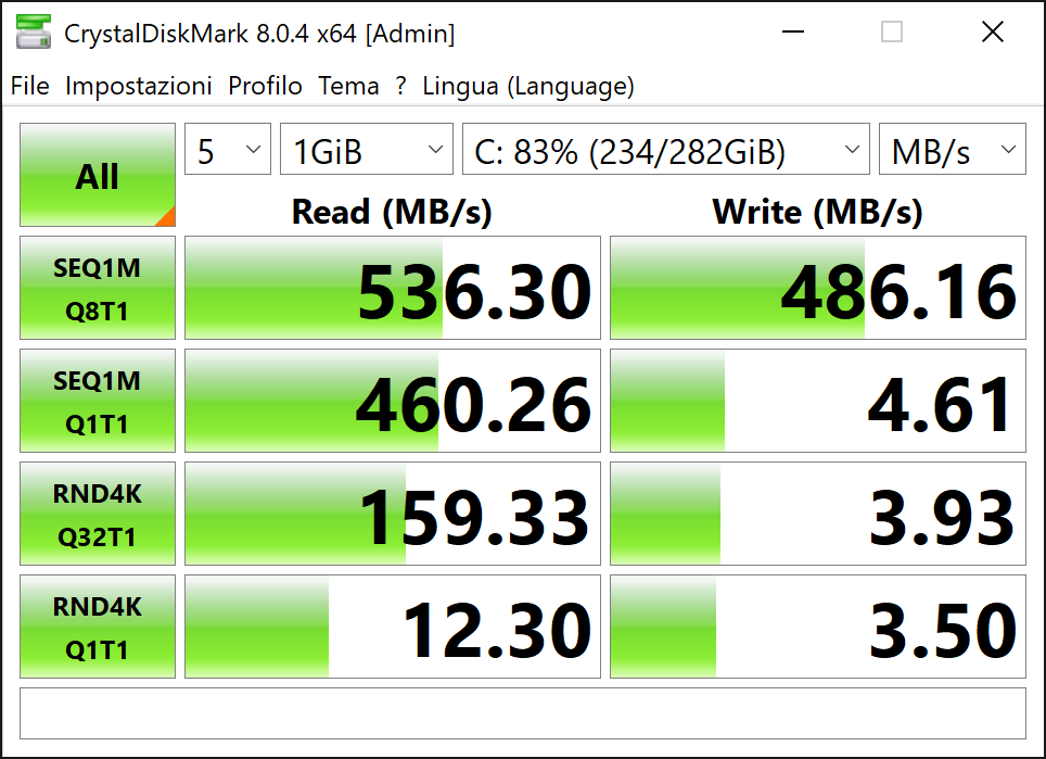

Speaking of which (the benchmark tools), I just tried a bunch of benchmarks in Windows and I keep getting weird results (see below). They look pretty inconsistent to me.
Also, please note that they were performed when my drive seems to be in a healthy state -- no particular lag observed during normal operations. Put it in another way, BlackmagicDesign's tool yielded these results a few minutes later, in MacOS:
which is in line with my expectations for this drive normal performance (or are my expectations too low?).
Any comments?
