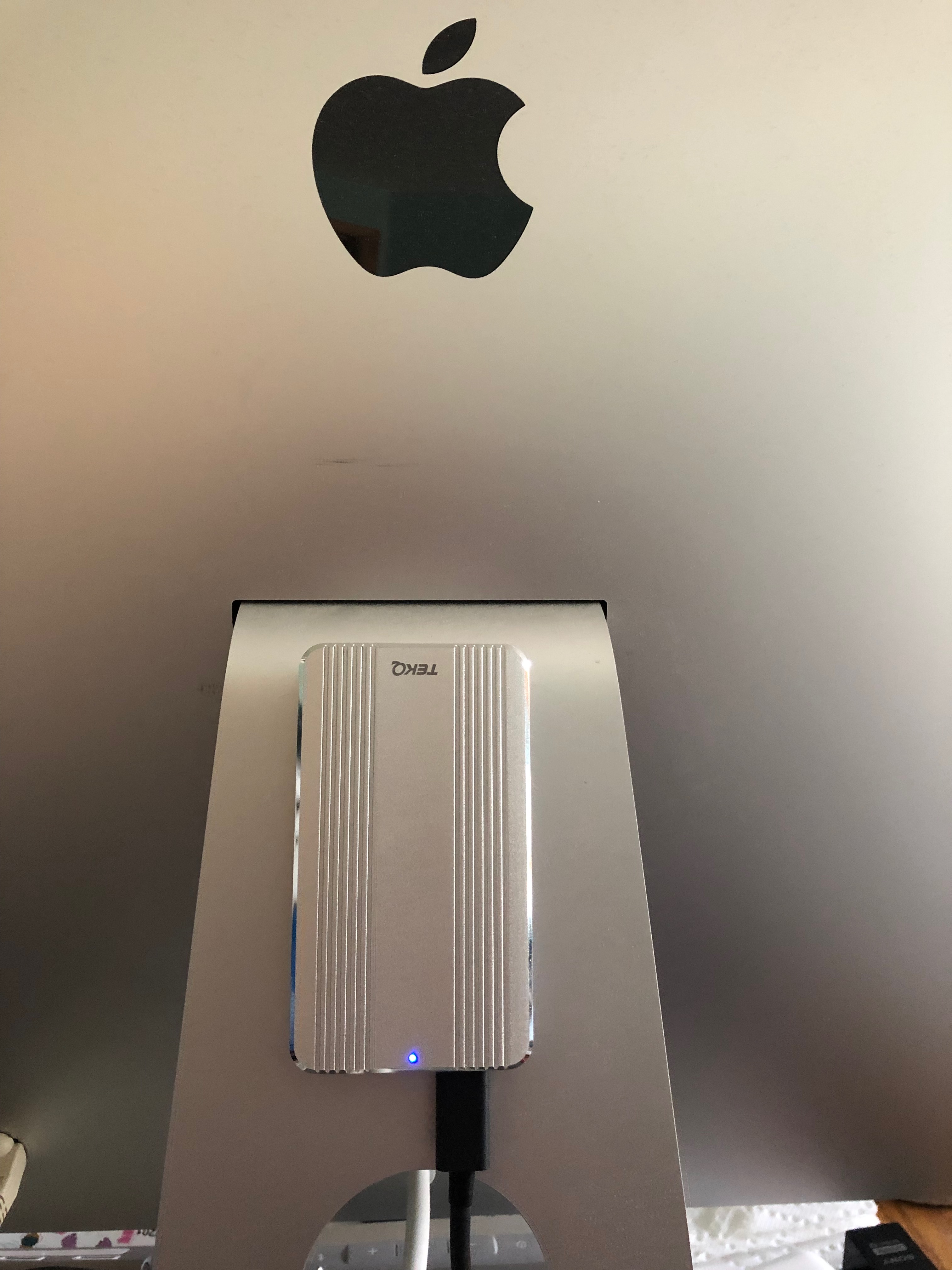

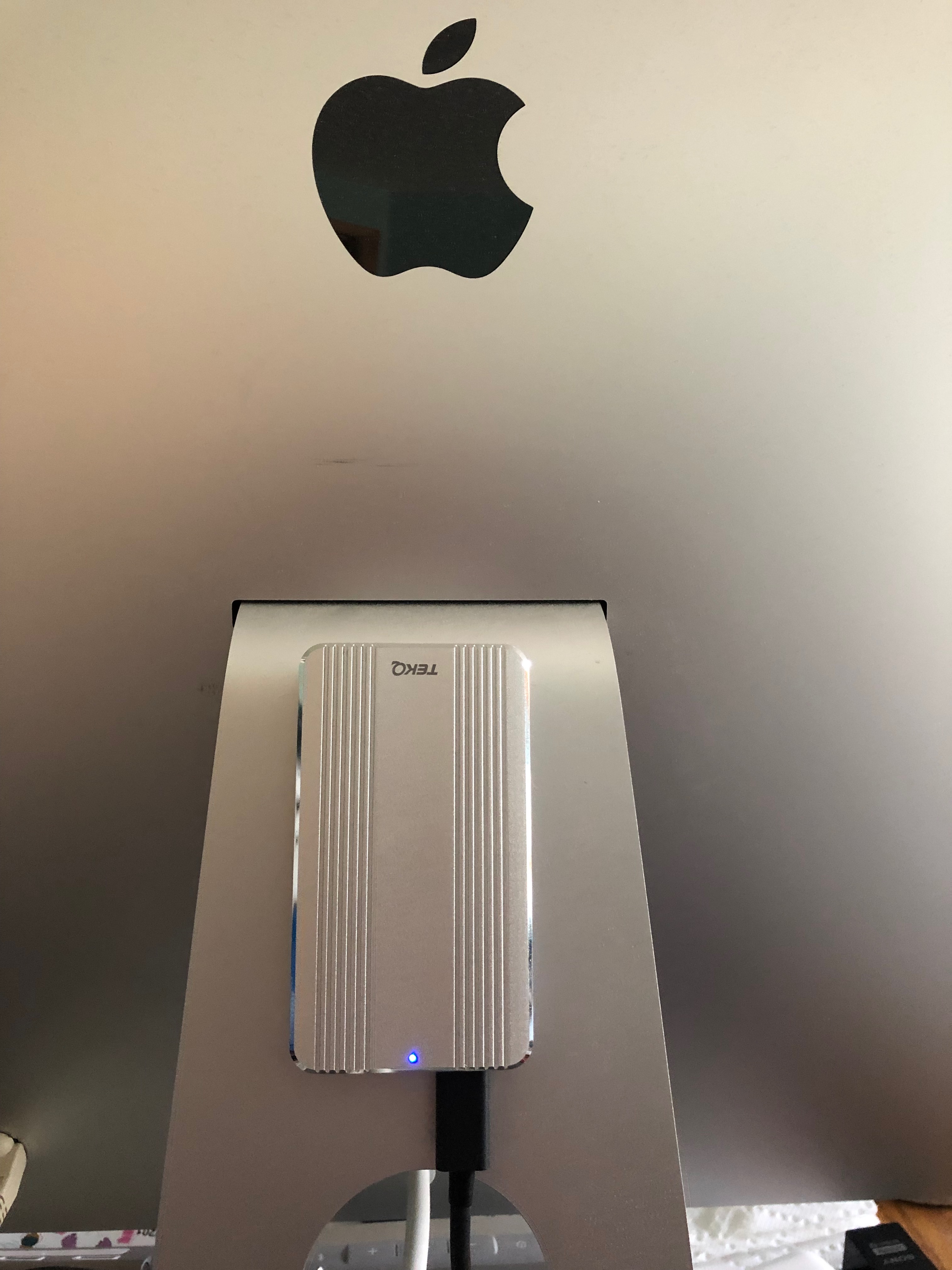

That is how I installed mine on a 2017 iMac. I didn't want to have Windows 10 resident on the internal 2TB SSD, so I temporarily installed it with BootCamp, then used WinClone to move it to an external 500GB TB3 SSD which is just about as fast as the internal SSD. I then velcro mounted the SSD to the iMac stand. It is working great!
480G TEKQ Thunderbolt 3 Portable External SSD Bus Powered Portable 2450MB/s Read / 1850MB/s Write
https://www.amazon.com/gp/product/B07C9C9D5T/ref=ppx_yo_dt_b_asin_title_o06_s00?ie=UTF8&psc=1
