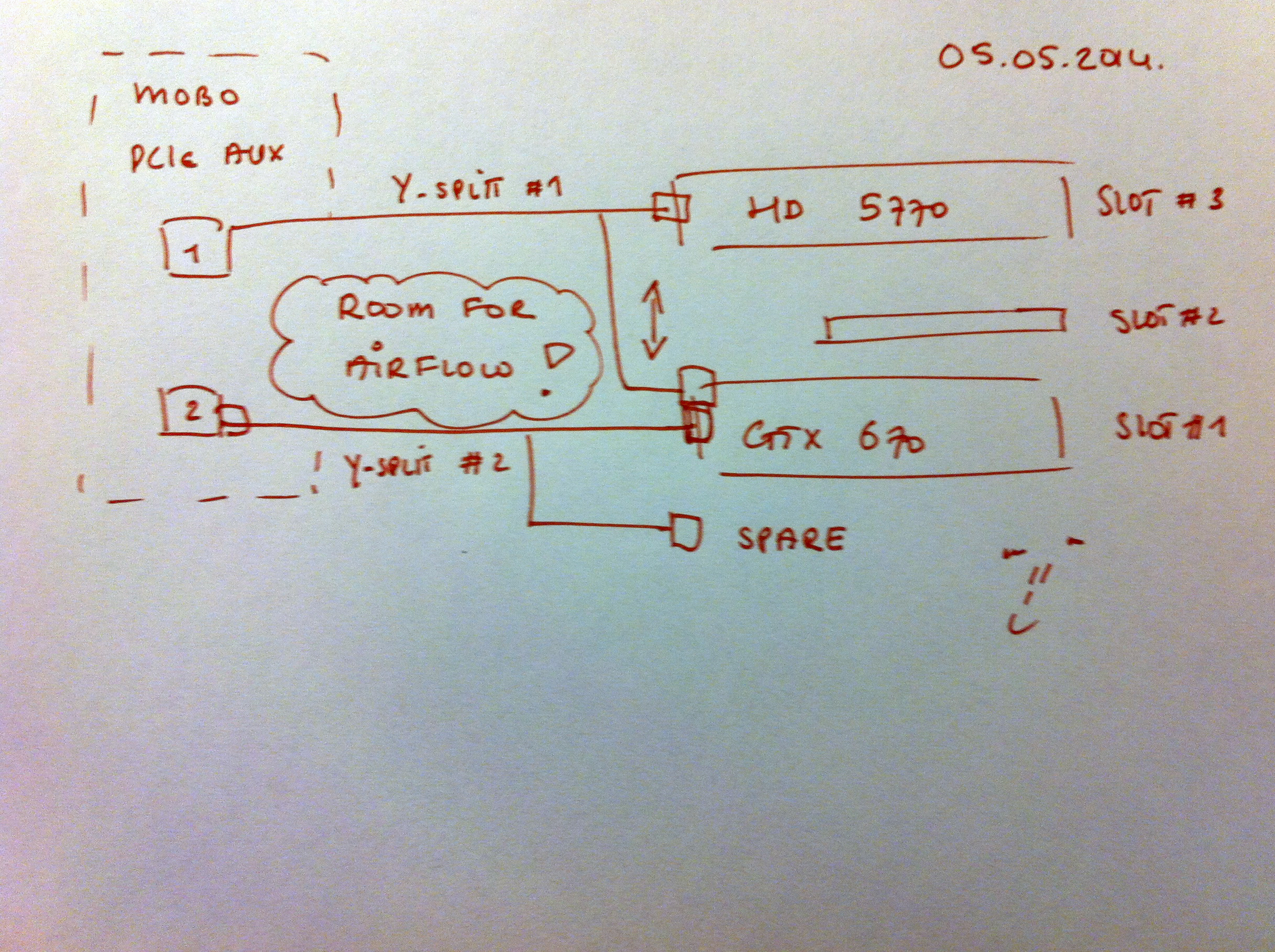

Ahhhh I understand what you mean now 😱 it is correct that the grey fanhouse needs to be removed to access the mobo power connectors.
Here's a drawing for you.
Good luck.

remove the fan could damage any part of the computer for the temperature?
After installing the cables the fan house MUST be placed back! The cables will just work placed underneath the fan house, it was engineered for it!
