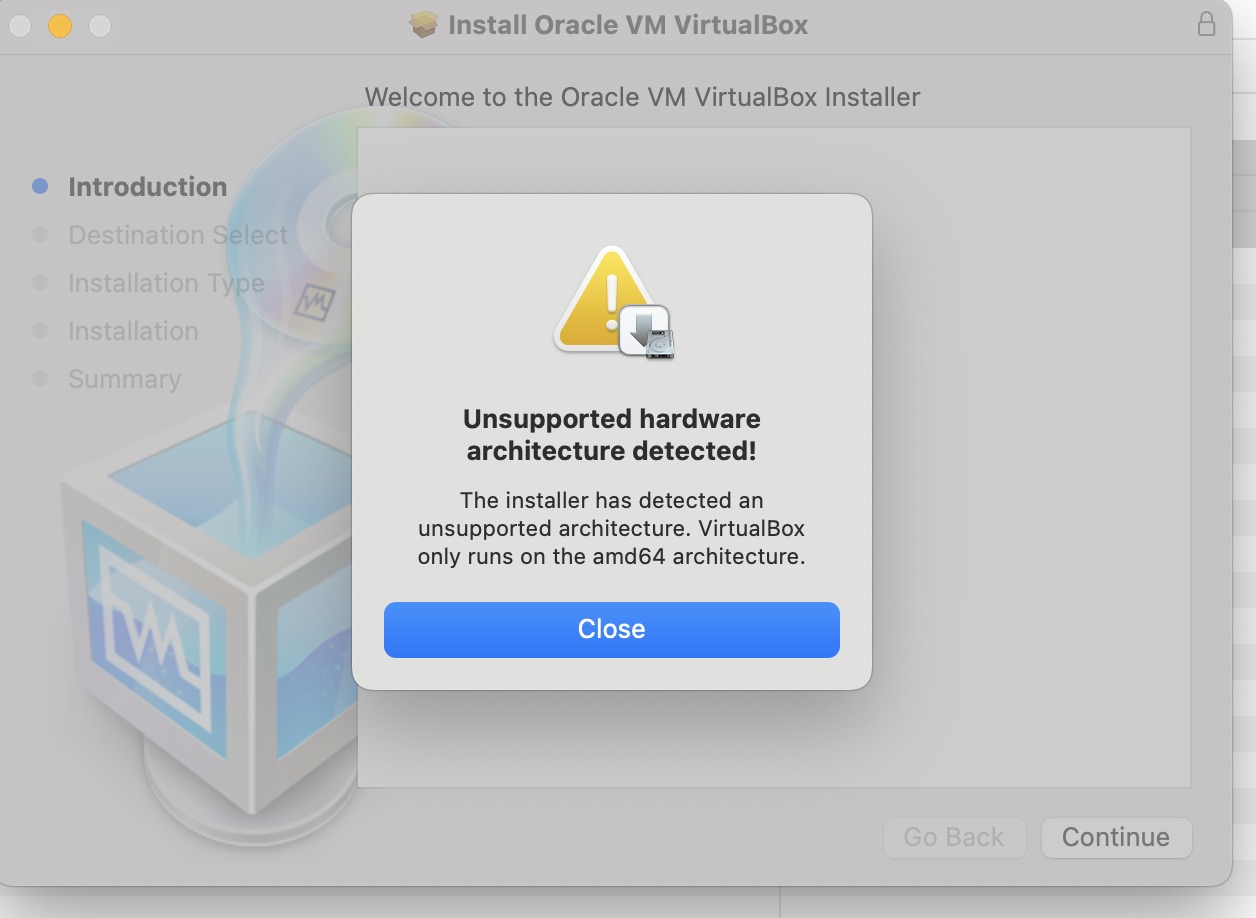

and yes, I tried installing VIRTUALBOX, and it doesn't seem to work for me ... I thought this version was for both Intel & Silicon Macs? (at least that's what it said!)
I wouldn't use VirtualBox for your situation (although I do use it occasionally). It is pretty finicky to set up, not so easy to use.

Apple silicon: Use one of the apps (free or paid) which can create macOS virtual machines using Apple's lightweight virtualisation. Free: VirtualBuddy. Paid: Parallels. Note there are restrictions on software inside the virtual machine - no iCloud.
Intel: VMware Fusion (free for home use) or Parallels (paid). Virtual Box is free, but difficult to use - not recommended.
