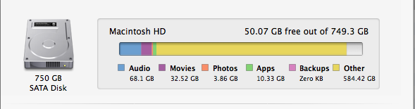

Hi all, Im running out of space on my Crucial M500 480GB ssd in my mid 2010 13' MBP 10.9/2.4/8GB/480GB/320M. So heres the deal i went through my drive and archived and deleted a bunch of files such as music, apps, and documents. The Hdd viewer in iStat menus didn't change after did all that, i thought i'd see at least a small change in the space available, but no luck. I have restarted and repaired perms. Any ideas? Here are some pics.

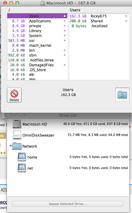

WOW! I used OmniDiskSweeper, very good app as i have tried the others earlier in my PPC days. ODS is not graphical which is perfectly fine, (i can read)

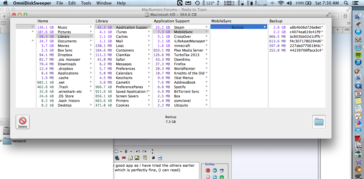

So it looks like Application Support is large with Steam, Mobile Sync and Crossover taking 30GB. I can live without Crossover, and maybe a couple less Steam Games, but what about Mobile Sync? I have 4 iPhn 5's, 1 iPad4, and 1 iPod Touch, I should probably save that.
Deleting more Music and Pictures is out of the question, although I could offload my iPhoto library to an external and point iPhoto there. That seems like a PITA though from a usage standpoint.
Anyway I appreciate the information "simsalad........."
You are one of the many folks that make MacRumors awesome, Thanks.

MobileSync contains all your iDevices' backups.
Like it or not, you're going to have to move your media (pictures and movies especially) off to an external drive.
That is your iOS backups through iTunes. Looks like you have six iOS devices backed up there, so I am guessing some of those are devices you no longer own.
Open iTunes and command-comma to get to prefs and look in the Devices tab. Remove any iOS devices from that list that you no longer own and that will remove the file from the Mobilebackups folder.

I'll figure something out as I have just gained 60+GB back with ODS
Thanks I do have 6 devices: 4-iPhn 5's, 1-iPad4, 1-iPod touch

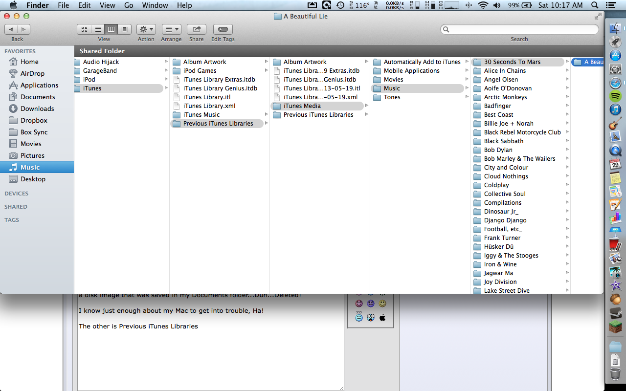

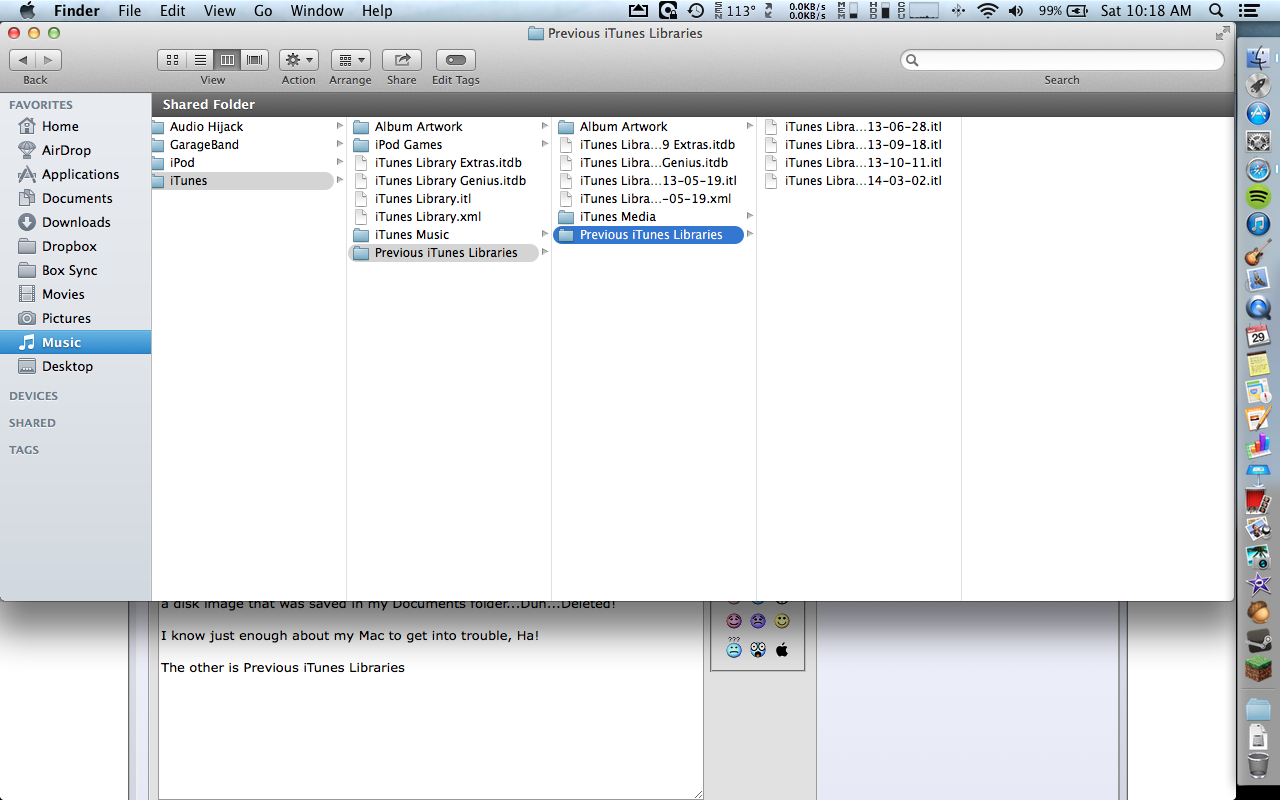

The other is Previous iTunes Libraries x2 as shown in the pic, 1 has actual itunes files, the other does not.
I just listened to The Mac Geek Gab show where they talked about this type of situation, I'll have to go back and listen to their proposed solution.

Uregent help needed
Screen Shot 2014-03-30 at 12.24.34.png ok so im not the best with macs more of a windows person but got a mac and now this has happened ive went through that harddrive and looked everywhere it says i have 500,000 files on it but i dont and cannot locate them, my mac should have about 500gb free of space not the ewntire harddrive full and sometimes it jumps up and down in size, dunno what to do here and please dont go off on a tech bomb just keep it simple on how i can fix this thanks
View attachment 466849 ok so im not the best with macs more of a windows person but got a mac and now this has happened ive went through that harddrive and looked everywhere it says i have 500,000 files on it but i dont and cannot locate them, my mac should have about 500gb free of space not the ewntire harddrive full and sometimes it jumps up and down in size, dunno what to do here and please dont go off on a tech bomb just keep it simple on how i can fix this thanks
Get OmniDiskSweeper and see what on earth's taking up so much space 🙂
More than likely these are local snapshots by time machine. Not a big deal.
http://support.apple.com/kb/PH14329
Open Terminal from /Applications/Utilities and paste in the command below then enter. You will be asked for your password and it will take a couple minutes to run.
When it gets done you will have a list of all the base folders on your machine and the size in GB of each folder. Post that output up here and we can help you out.
Code:
sudo du -d 1 -x -c -g /
Also, you might try a command-r boot to recovery and run Disk Utility from there and do a repair disk to check for any disk errors.
