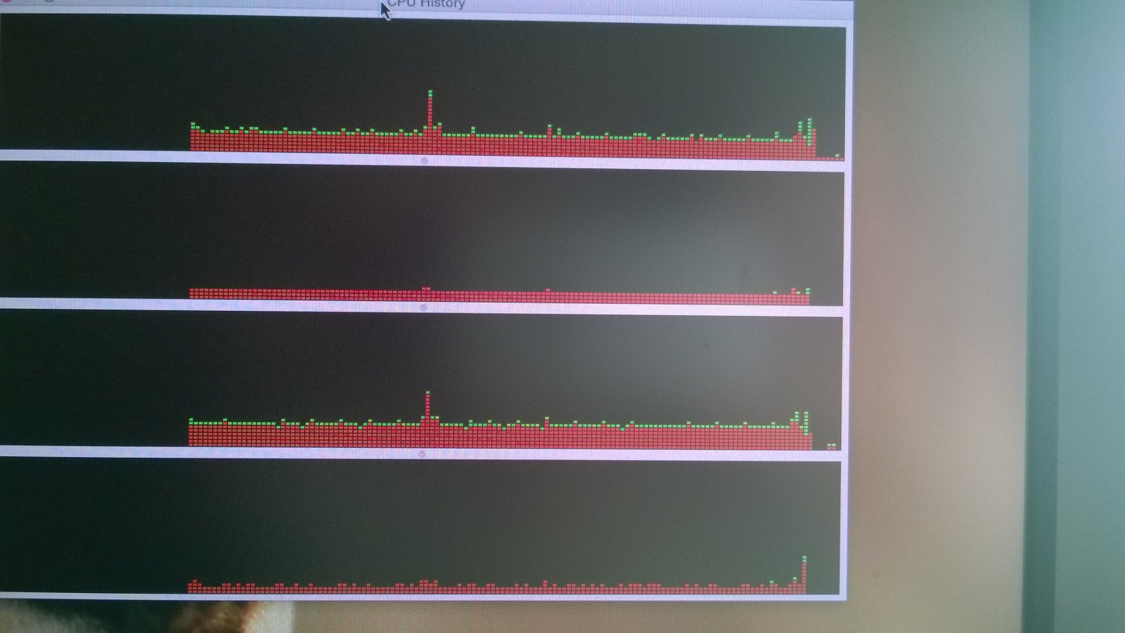

Just got brand new 2015 MBPr 16/512. Main purpose was to get rid of my quad-core beast desktop and move my working VM into laptop. It's easy because I was using VMWare Workstation on desktop.
I'm happy that everything works well and probably better than expected. CPU-intensive tasks on this i5 2.9 with 2 cores is not any slower than on 3 year old quad-core i7-2700k. Windows even gave it more score 🙂
However, see what its doing to CPU. VM stable, no activity going on in W8. You see I suspended VM at the end and CPU went to 0.
Is that a VMWare tax on CPU? How is windows doing when in BootCamp?

I think you're seeing the virtualization tax on the CPU. I run a Windows 8.1 VM with Fusion on a 2012 Mac Mini and I'm seeing similar results (though across more cores in my case). And like you, the moment I suspended the VM activity went to zero.

Actually, my VM is my work environment. I'm developer. Visual Studio, SQL Server, Android development, etc. I'm giving VM 2 cores, 8Gb and 1Gb video. I tried giving it 4 cores - no change
I had quad-core system before (desktop) for the same task and it was completely adequate (same exact VM, but host was Win7)
I'm working in this VM second day now and see some sluggishness in comparison to old box but it's acceptable so far..
I had to do a demo (use JoinMe screen sharing) today. WOW. Just running JoinMe inside VM taxed CPU around 60% opening browser after that and poor Mac started to blow hot air 🙂 I run Android emulator (pretty much VM inside VM) and it was almost "dead" performance-wise. Horrible...
I plan on keeping it, will move non-windowns specific apps to the mac side.
P.S. I tipically don't run 2nd VM, only for short periods while setting up or configuring.

Sure there is something going on, maybe 3-5% utilization if looking inside VM. Some of it SQL Server, some of it IE, little by little it takes up CPU. But it wasn't near that on a host-side when running on Windows host.
Interestingly though, this little mac beat my "beast" desktop in Windows score on EVERYTHING except video. Video scoring suck. CPU 6.1->6.9 (surprise), Mem, hard drive, all do better. Video - 8->4 downgrade.
MacBook 15 definitely going to do better but for me it wouldn't make much sense, why did I get laptop in a first place? To use it on a lap if needed. Or move around..

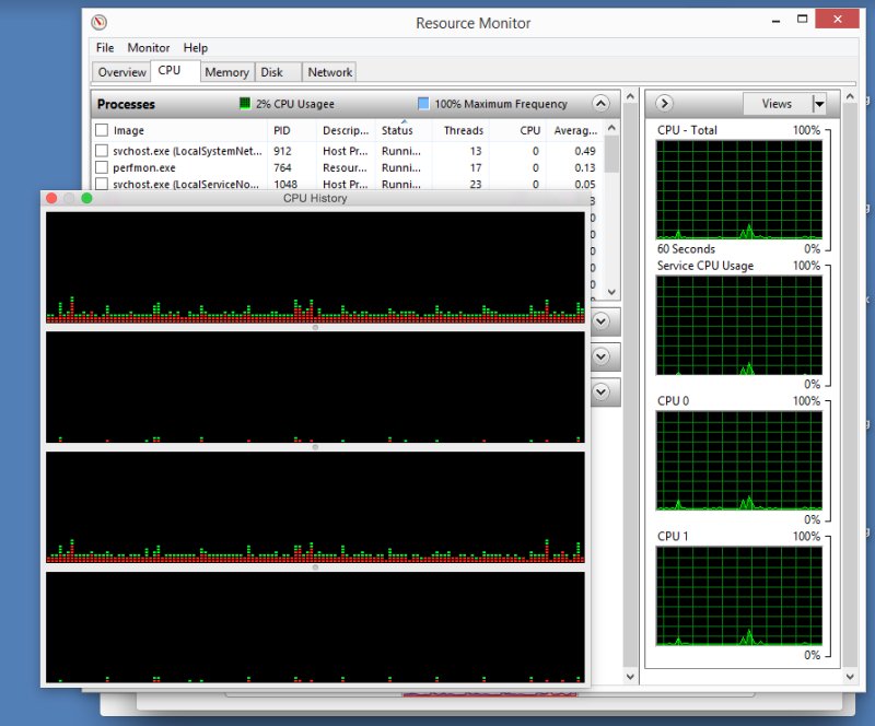

Here's what it looks like on my MBP 13" with Win8 idling at ~2% (see Windows performance monitor in the background):
Hi Rigby! Thanks for you screenshot.
I shutdown bunch of services on Windows 8 and made it idle at <2%, mine looks like it's idling completely comparing to yours.
But, on mac side I see CPU about x2 of what is on yours and it's stable, no even slight peaks. 2 cores completely 0 and 2 cores about 2x of what is yours. Actually, it might be really close to yours, hard to tell for sure..
Can you post your VM specs as far as what you do for CPU cores, RAM and Video? CPU settings and other advanced options? I wonder if it's some kind of setting in VMWare that can make this difference?
The VM has 4GB RAM, 2 cores, up to 512MB graphics memory. All other options are on their defaults.
