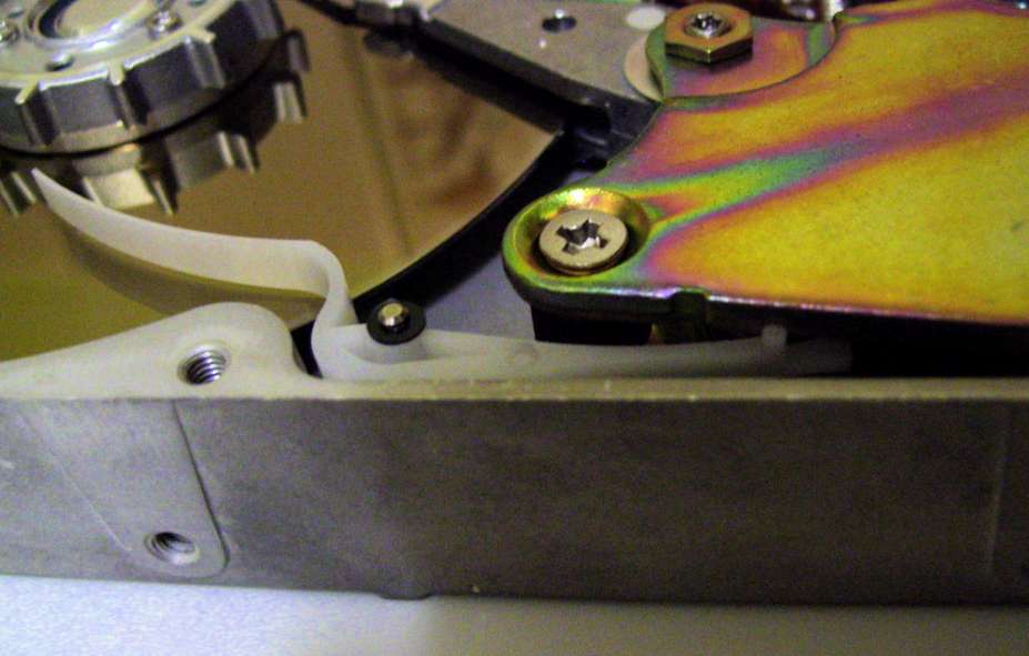

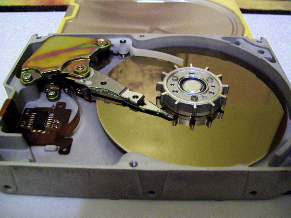

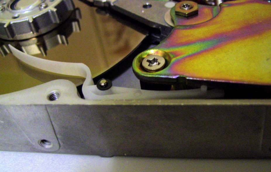

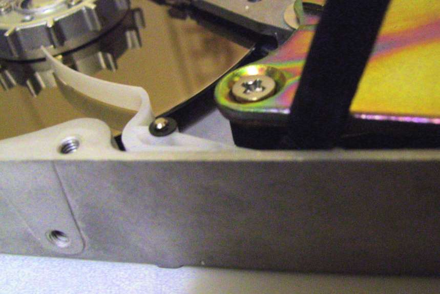

As for the floppy disk with question mark, the hard drive model in your picture is very prone to a head park locking mechanism jam.
There's a nylon plastic arm that has a pivot point about it's middle. One end locks the heads in place, the other is positioned over the spinning platters. When the drive spins up, the airflow is supposed to move the end of the arm, dis-engaging the lock. With age, they get stuck.
You can get past it to get data off by giving the drive a lateral twist but you must do it before it attempts to calibrate, or it will spin down.
I'm assuming the lubricant on the shaft that the arm sits hardens, preventing the arm from moving with just the force of the airflow.
Sadly, I've not needed to work out a permanent solution, I've only manually unlocked the arm to recover customer data. Removing the arm is not advised since the heads will skate all over the platters when the platters are not spinning, causing damage.
Pics are attached.
EDIT: Of course, removing the top cover is ill-advised at the best of times, and if you attempt it, you must do it in as clean an environment as you can, and place the top cover on the drive when you can. It's possible that removing the arm and cleaning the shaft and the hole in the arm might resolve the problem without the need for any lubricant. Be very careful, if you touch or mark the patter, you can pretty much kiss the drive goodbye! 😱
