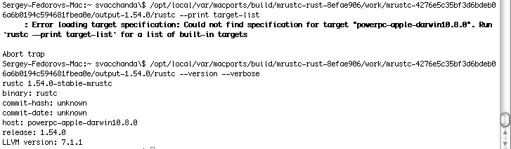

Well, it took 4 days to fix one bug which was added in 1.54 and another bug which was fixed later (as it turned out), but was unfixed in 1.39 and 1.54 – and was driving me mad. The issue itself was trivial, but finding it was a pain.
Now it cannot figure out that powerpc-apple-darwin10.8.0 (which is what LLVM uses, but it accepts non-versioned triple as well) is the same as powerpc-apple-darwin...

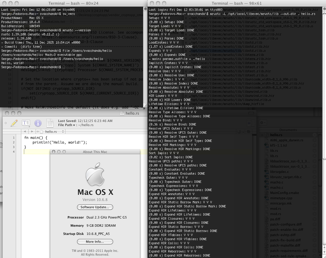

Ok, here is a reproducible [hopefully] example of an actual Rust app running on powerpc. Assuming you have PPCPorts installed:

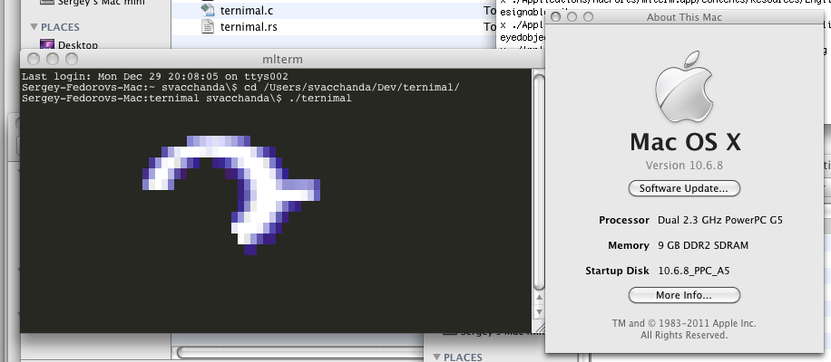

Now compile and run:
Code:
mrustc ternimal.rs
./ternimal

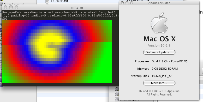

Try the same with options, and described in README here: https://github.com/p-e-w/ternimal
You need a modern terminal emulator to have correct rendering.
`mlterm-minimal` port works. `sakura` should work too (X11).
In iTerm2, MacTerm and Apple Terminal rendering is weird, but it still works.
