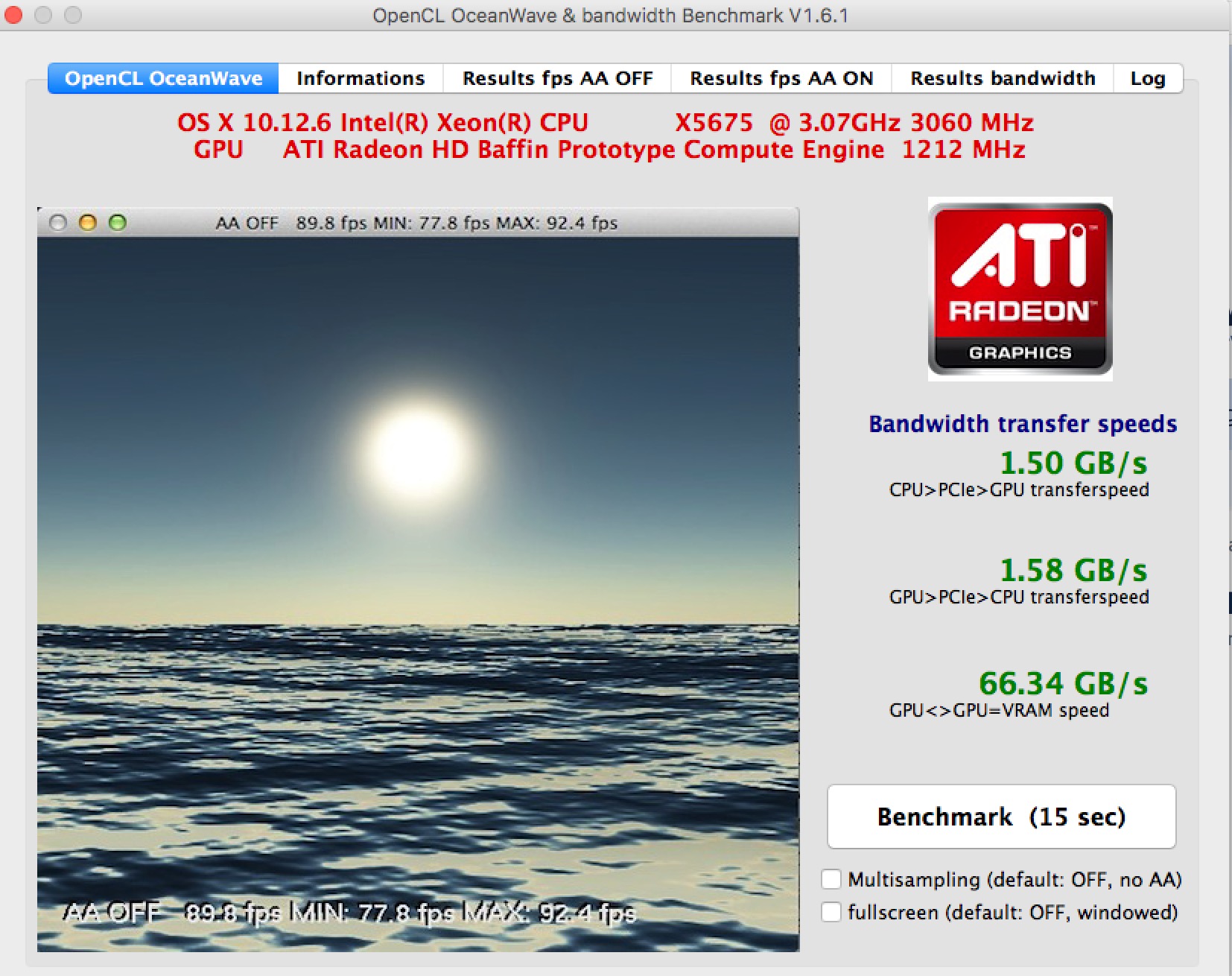

Anyone have a RX 460 running in their cMP 5.1 in Sierra? Do the results in the screenshot seem typical for the bandwidth speed? Lastly, I'm I the only one who has a somewhat choppy UI sometimes?

I just check the spec of RX460. It seems the card is PCIe 3.0 x8. Since you can only get PCIe 1.1 on cMP, that means PCIe 1.1 x8. So, 1.5GB/s is the correct number indeed.
I'm not in the loop of current events, but many guys here have RX460 so they'll answer you soon enough.
My assumption is that all is ok.
Non flashed AMD cards are working at PCI-e 1.1 speeds in cMP, and RX460 is a x8 card. So speeds you're getting are expected when using just eight lanes of first gen PCI-e interface.
Hope that someone will correct me if I'm wrong.
EDIT: Haha, one minute faster 😀
Thanks for the responses, very knowledgable. I haven't seen anything about the rx460 being able to be flashed for PCIe 2.0 or am I wrong? Also, so everyone with a RX480 or RX580 in their cMP are also running them at only PCIe 1.1?
AMD card cannot be flash to PCIe 2.0. Some card like R9 280 can be mod to support PCIe 2.0 via resistor 17 removal. But for most AMD card, we don't even know if such a resistor exist.
Anyway, by considering the RX460's performance. No need to worry about PCIe 2.0, PCIe 1.1 x8 is enough for most GPU operation.
