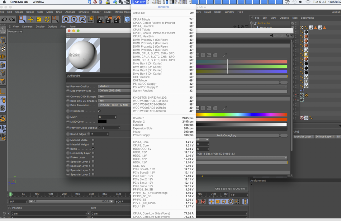

70c is no problem for a Mac Pro 5.1

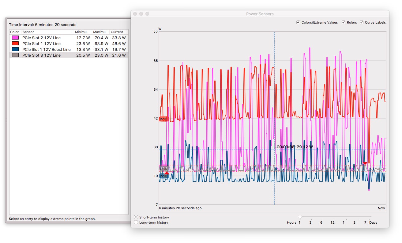

Hard to know what to blame without seeing the data. Install some monitoring software so you can see how many watts the GPU is pulling from the slot and socket.
