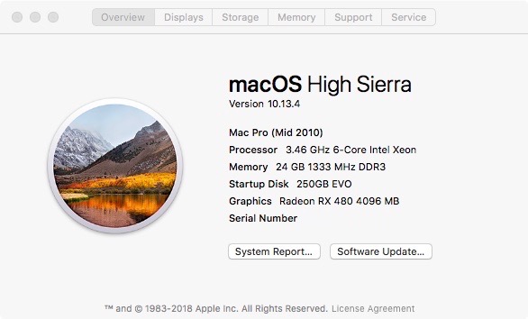

I'm about to do the same thing to my Mac Pro. I have an RX480 in another computer that I'm going to swipe and put in my Mac Pro. Does anyone have a link to the power connector that will be required to get this sucker up and running. I still have my stock GT120 and will probably just keep it in there if I ever need a boot screen for some reason. Any links? TIA.
Reference RX480? How many connector / pin on the card?
Thanks. Works like a champ! Even properly identified by the OS. I guess that's been fixed from what I've been reading.
