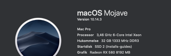

Any idea why Mojave doesn't recognizes my computer as a "Mac Pro 2012" but just "Mac Pro" ???
Apple uses a query with a remote server to determine the year model, based on the serial number. Usually when you do a re-install and don't have internet connection, stays as Mac Pro. After the query is done, with internet connection, changes to the year model.
