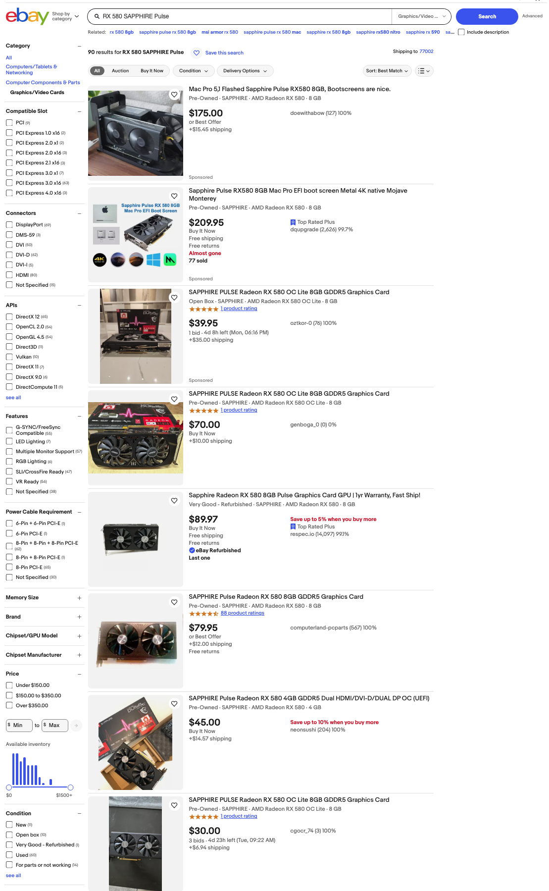

Seems like there a many RX 580 Sapphire Pulses available on ebay.
