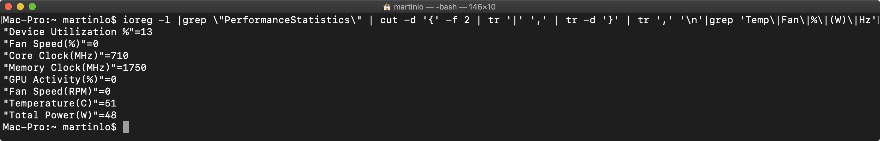

You can use this command in terminal to monitor the RX580's parameter in macOS.
Code:
ioreg -l |grep \"PerformanceStatistics\" | cut -d '{' -f 2 | tr '|' ',' | tr -d '}' | tr ',' '\n'|grep 'Temp\|Fan\|%\|(W)\|Hz'
In Windows, GPU-Z or even Wattman itself can easily monitor the GPU's temperature and clock speed.
If should be very obvious if the GPU is overheating. (Clock low, fan high, temperature high)
