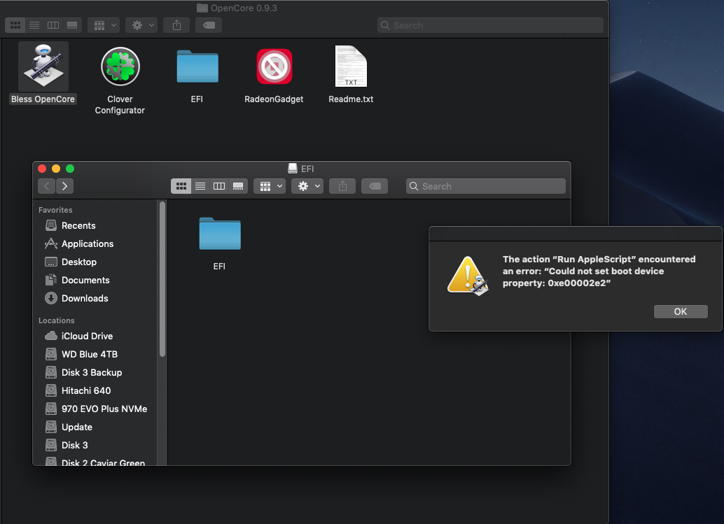

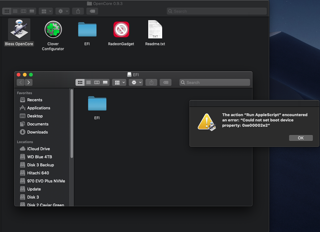

Thanks. I ordered an non-flashed Sapphire RX580 because it's less power hungry and is 40mm thick compared to the 590 Nitro which is 43mm thick. This way hopefully I'll still be able use PCIe slot 2 with a riser cable for my NVMe SSD. Currently I'm still using a flashed GTX680 (38mm thick) and trying to install MLOC onto a bootable thumb drive. I installed a fresh copy of Mojave onto the thumb drive, reset NVRAM and disabled SIP but can't bless OC. In recovery it shows successfully disabled SIP but when I reboot I see it's enabled with custom configuration. View attachment 2245715View attachment 2245716
Please completely disable SIP to run the bless tool.

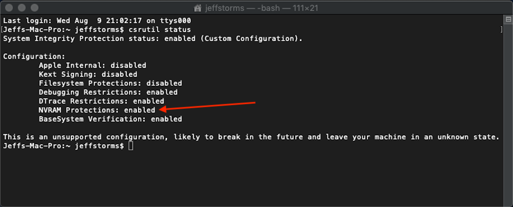

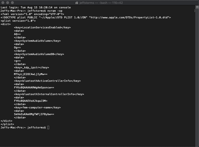

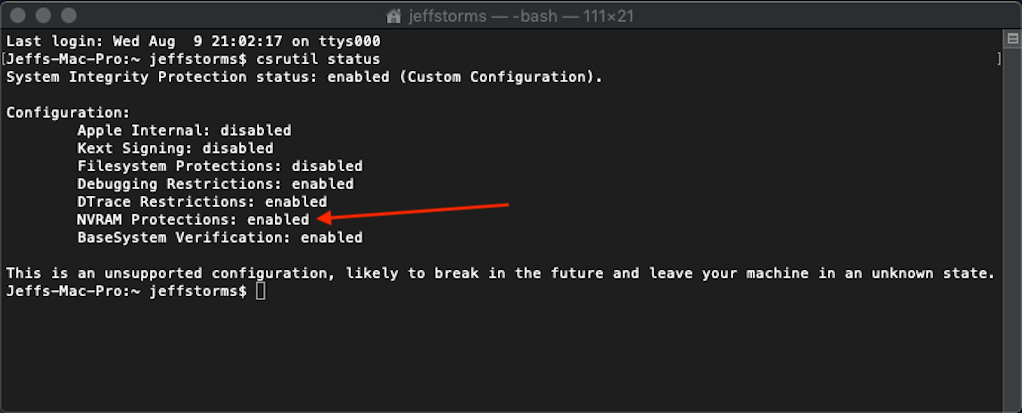

I've tried at least 20 times over the last few weeks to disable SIP but cannot make any changes to SIP. I've even tried entering individual commands, e.g. "csrutil enable --without nvram" but I am unable to make any changes. I've followed the precedure multiple times, I reset nvram (chime 3 times), then boot into Recovery and disable SIP successfully but when I reboot normally, SIP does not save commands. Something happened when Monterey 12.6.8 security update crashed the boot partition. I was able to disable SIP and install Monterey using OCLP over a month ago but after the crash, I had to restore a TM backup of Mojave without OCLP. Now every time I try to disable SIP it does not save changes. There is very little info about this issue on the Web, I can't figure it out?
EDIT: After researching I believe my system's SIP status shows my last configuration that was implemented by OCLP before 12.6.8 security update crashed OC boot loader when I had Monterey installed with Post-Install root patches. SIP is now now locked into that configuration somehow? I can't reinstall OCLP to disable SIP as I would have to first disable SIP to install OCLP.

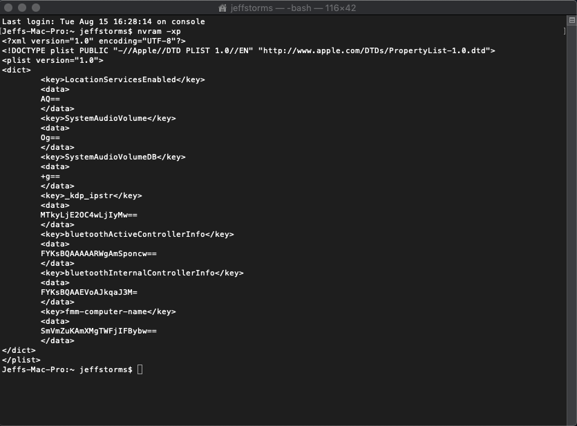

EDIT 2: Typed nvram -xp in Terminal.
No "csr-active-config" or "efi-boot-device" ?
Should they be listed?
Should they be listed?View attachment 2246437
Your GTX680 is flashed?
If yes, you can simply hold Option key to boot, and use Control + Enter to "bless" OpenCore (the EFI entry in that boot manager).

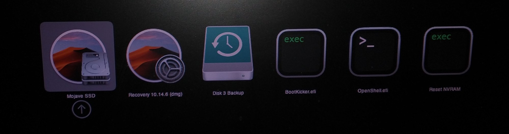

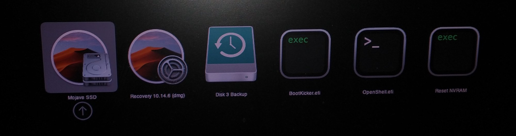

Yes it is flashed. Can you explain what you mean? Boot into what? Are you referring to my screen capture above where I'm booted into Mojave thumb drive where MLOC is loaded?
These are my options at boot screen:
These are my options at boot screen:View attachment 2246505
If you are already running my package. Then you don't need to run the bless tool. It's already blessed.
And SIP is controlled by the OpenCore config.plist. That's why you can't disable it in recovery partition.
But your "current boot screen" is the OpenCore boot picker, not the native Apple boot manager.
You are already running OpenCore. OpenCore is already blessed.

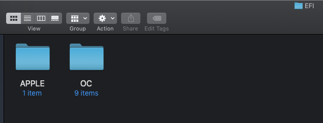

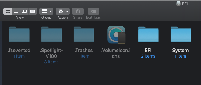

I think What I have is a dysfunctional version of OCLP that installed with my TM backup. I apparently did not choose a backup that was pre OCLP installation. I have only tried to run your package from a thumb drive, I did not try to install it to my boot drive yet as I was afraid of crashing my boot partition again. So wouldn't that produce the error I posted above when I use the Bless Tool? Also when I run Monterey installer It tells me it cannot be installed to this disk. I'm almost sure that I had the OC boot picker since installing the TM backup. I'm sure you can tell me if that's the case by looking at my EFI below.
OK, does this mean that I have OCLP 0.6.8 installed? If so, I can just follow instructions here: https://dortania.github.io/OpenCore-Legacy-Patcher/UNINSTALL.html to remove it then install MLOC, right? I'm not doing anything until I get confirmation from you Martin. I don't want to spend another 2 weeks in limbo trying to figure out what I did wrong.

we can see OpenCore is blessed (BootOrder0001),
OpenCore is sitting in Sata Bay 1, on the WD500 drive.
The path was disk1s1 during reading the dump file. The path varies from boot to boot.
You can use my little script: mount ESP from list. This shows Sata Bay 1 and WD500ish, too.
config.plist in the ESP also shows the OCLP version.
OCLP 0.6.8 was written in a NVRAM variable. That dont mean it was running.
The Romdump-timestamp.log shows if OpenCore runtime variable was written. Firmware spoofing is another clear sign of OC running or not. Both should be read in the log.
Those are some data points to troubleshoot with the information the Dumper gives.
