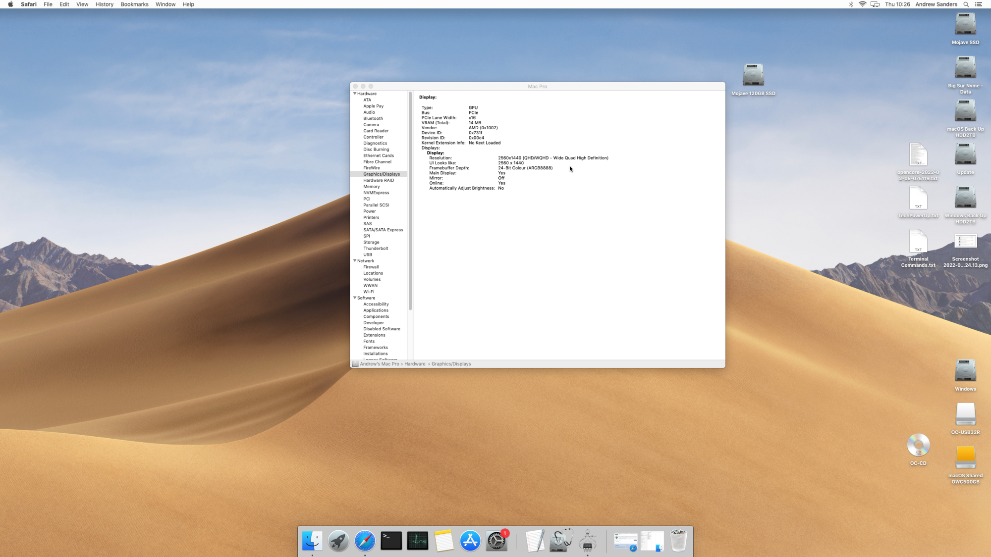

I was surprised that Mojave booted also, I thought that this card was not supported and wouldn't post, it doesn't identify correctly in system report, but still it boots for recovery use?
There are no drivers for NAVI GPUs before Catalina 10.15.1, so when you boot Mojave the display is unaccelerated and works via OpenCore GOP support and Apple EFI drivers. While you can't work, it's useful for diagnostics.
If you boot Mojave without OpenCore, the display is not going to work.
Thanks for clarifying, I’m keeping the rx580 just for Mojave rescue environment.
