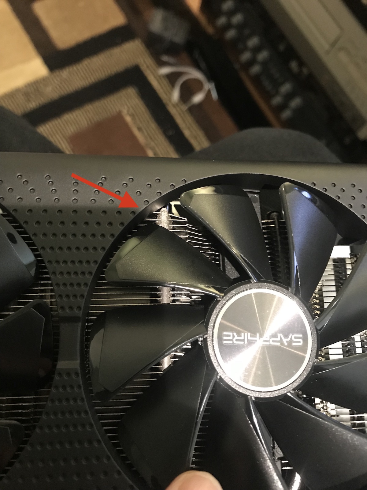

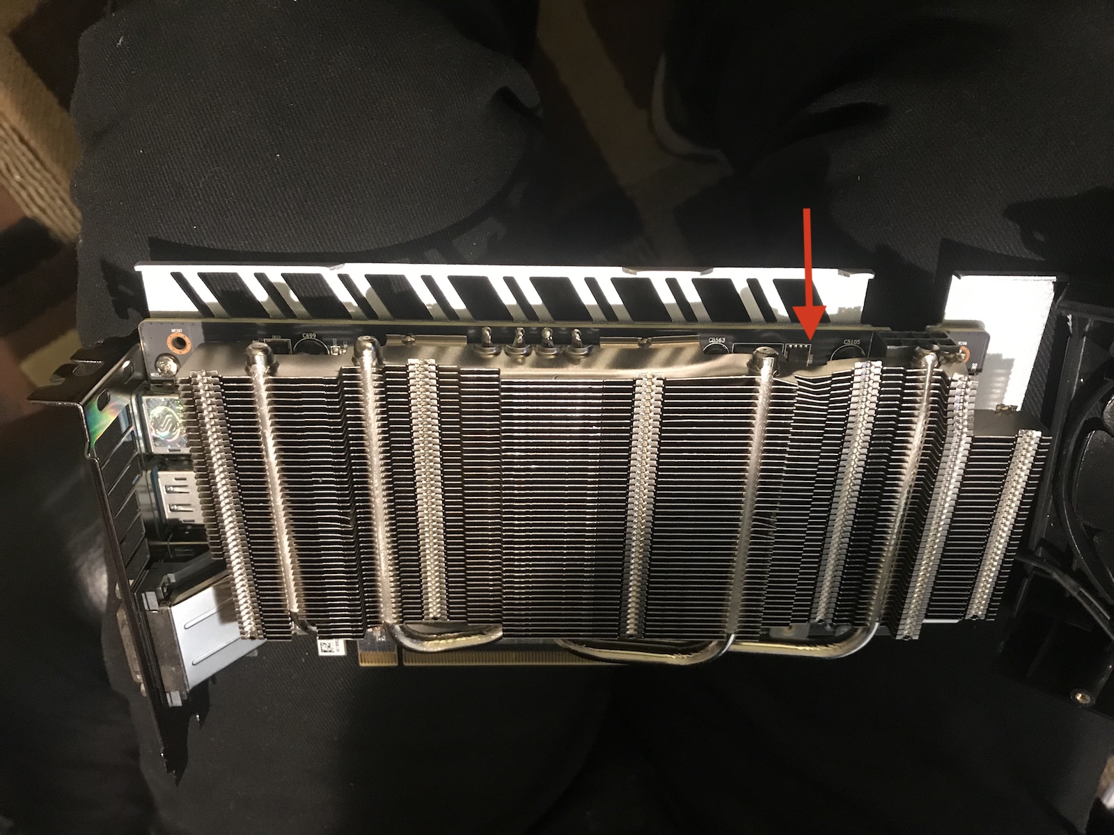

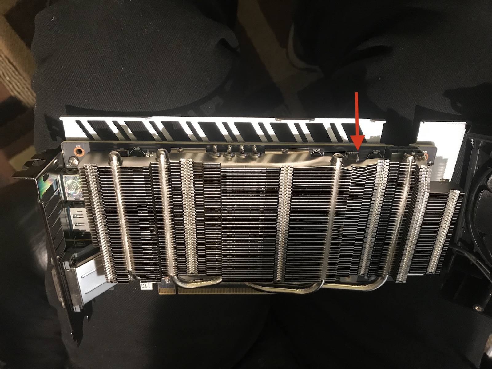

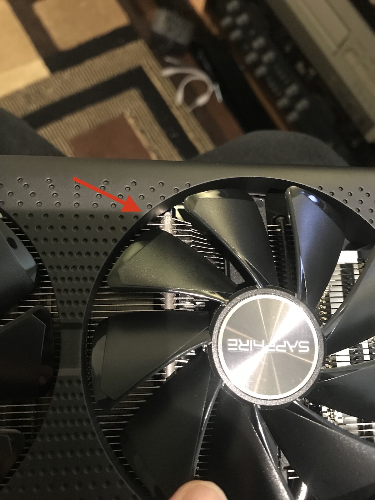

Thanks. I pulled the card and put the 5770 back in. Silence 🙂 I took a detailed look at the card and saw a bunch of stuff that looks odd. I pulled the fan shroud off just to get a better look. The heat sinks seemed to be bent on some and it looks as if the heat sync assembly was bent to get it to fit? I don't have another card to compare it to so don't know if their all that way. Attaching some pics. Looks like just bad QC. These are the fins NOT under the fan that is maxed but doesn't look right nonetheless. The box was unopened and fully sealed so this must have taken place during manufacturer.

Factory seals on the box and packaging weren't broken.... I know that doesn't mean much but regardless, its' pretty weird...
For those who read this in the future. I ordered a new card. It arrived and there were no bent fins anywhere. Plugged it in and it was absolutely dead silent with no issues.
