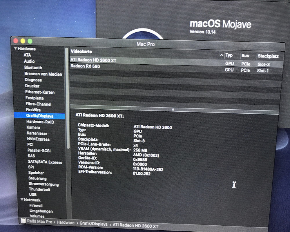

We tried also a stock HD2600 with same results. Guess the place to fiddle is the driver for the RX580.
So confirmed NOT working with RX580 is:
GT120, HD2600, HD5770
Pulling the second EFI Card is not the solution when wanting a boot screen with a RX580 🙂
[doublepost=1540722004][/doublepost]And btw, the HD2600 works acceptable when injecting the old drivers with DosDudes Tool. At least enough for a usefull screen for mails, palettes, and alike.

this was with metal deactivated:
next idea is to load the (metal) driver when Mojave is up and running
