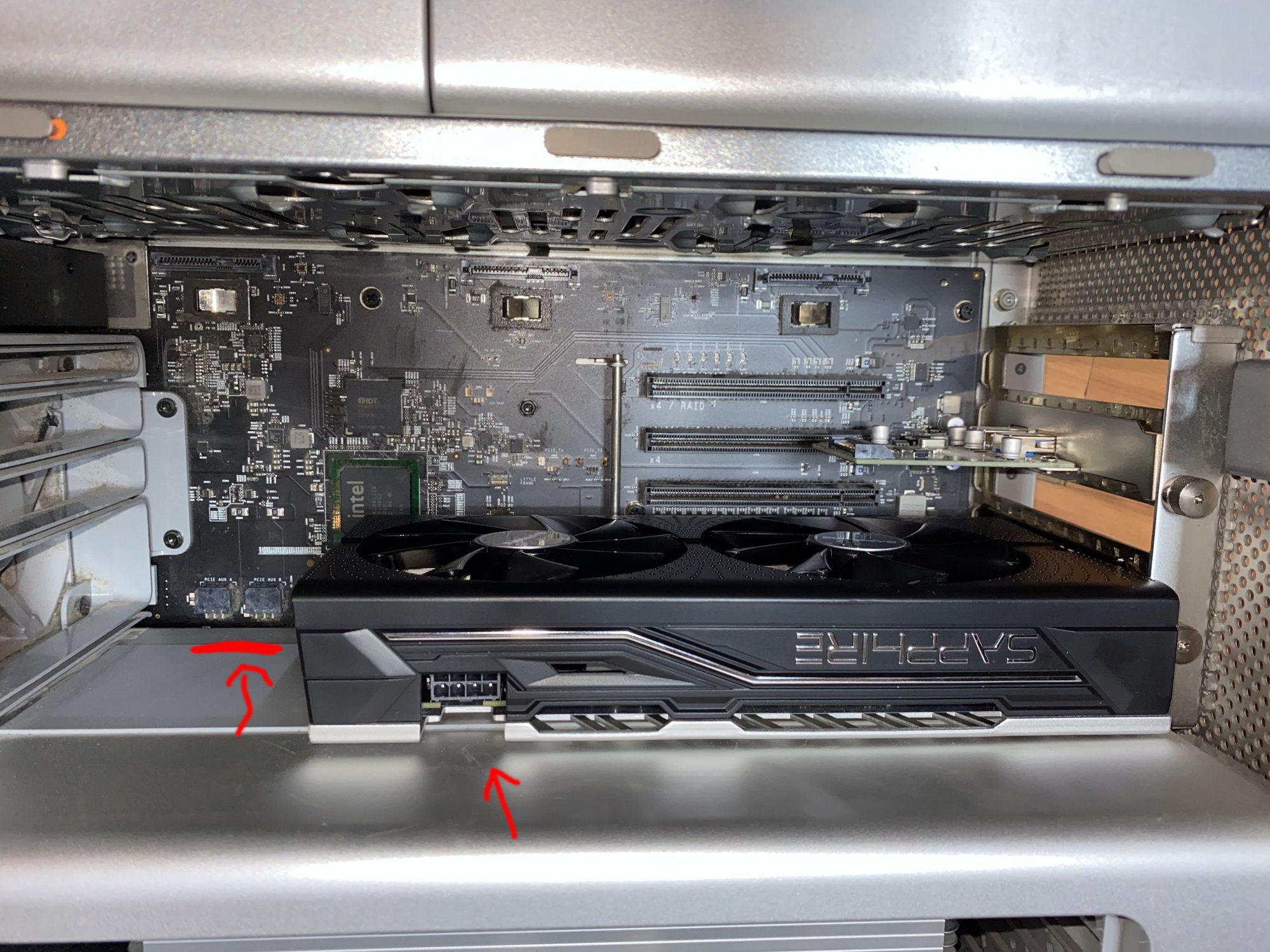

MIKX
macrumors 68000
Dec 16, 2004
1,815
691
Japan

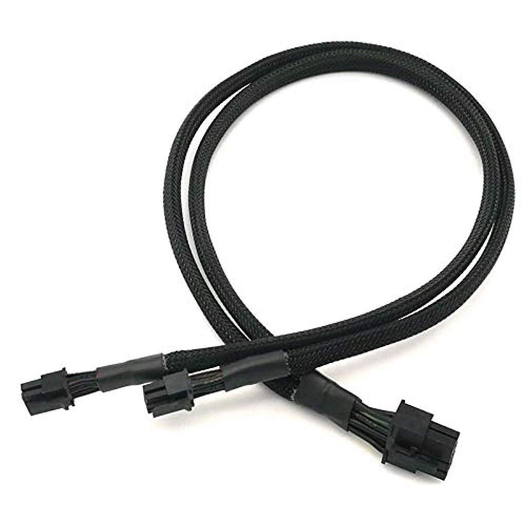

Send us a photo of the card and it's POWER sockets.
Theoretically the power cable should be this one.
Link to the cable : https://www.amazon.com/COMeap-Expre...PCI+cable&qid=1590342143&s=electronics&sr=1-1
fersy
macrumors newbie
May 20, 2020
24
4

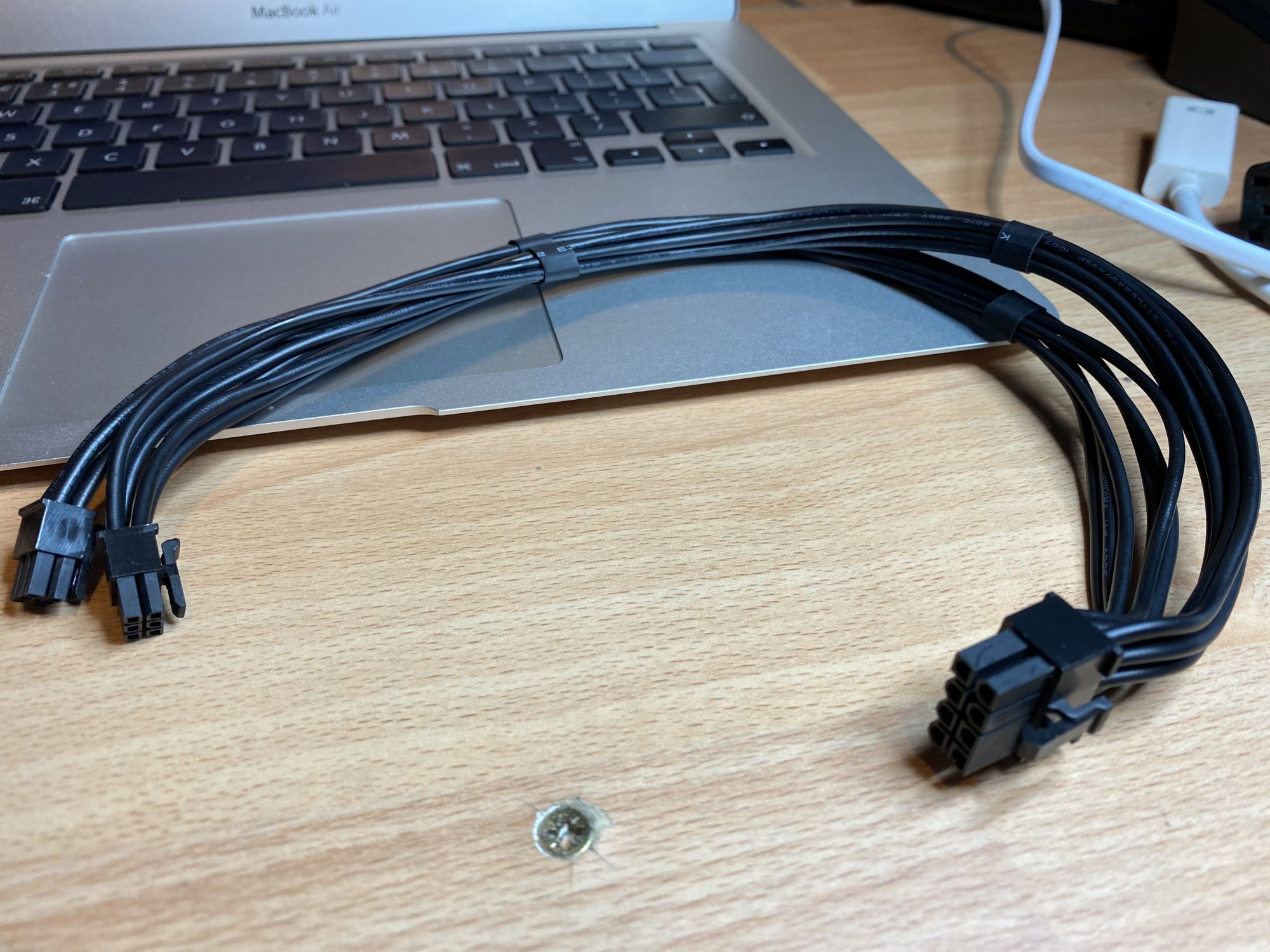

here is a pic of the sockets. I've removed the cable to see easier. obviously. i normally have the cable plugged into them when im trying to boot up lol.
[automerge]1590357287[/automerge]
and the cable

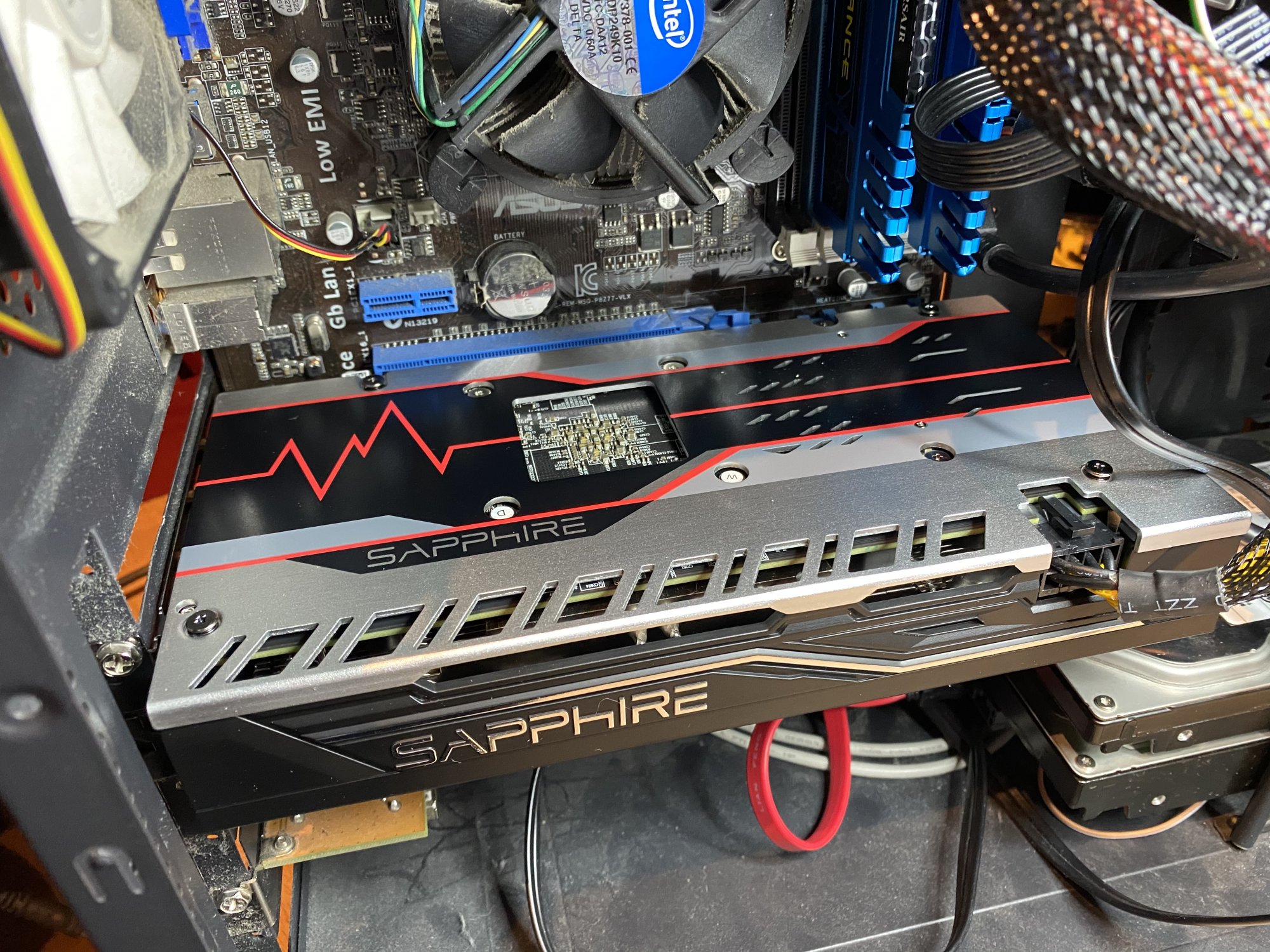

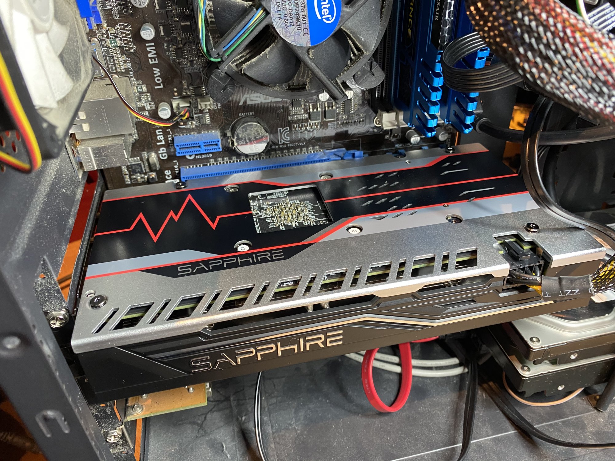

Ok so i put it in the windows pc and at first attempt the fans spun up but there was no picture just thru hdmi into my small monitor so i tried plugging in the display port too of my bigger momitor and then both displays came on and i got to the os selection screen then it seems to have gone tits up again but that may be something to do with the os where i maybe need to disable the onboard graphics or something becauee im pretty sure the intel i5 uses nvidia graphics drivers for onboard graphics. So basically the cards not dead anyway. See thats why i was thinking it was maybe a power issue on the mac because even if it was a compatibility issue on the mac id have thought the fans would spin up even for a brief second and it would show some sign that there was power going to it. The problem with all the other stuff like bootcamp wimdows etc is i cant even get anything on the screen to boot into it and i cant keep my stock graphics card in too as it also requires use of the 2x mini 6 pin aux sockets?‍♂️ All fun and games lol.
tsialex
Contributor
Jun 13, 2016
13,121
13,318
Not one Intel processor has NVIDIA graphics. Ever.
The only partnership that Intel ever made for Core processors was with AMD, some 8th gen Intel Core i5/i7 have AMD GPUs internally.
Some very old ATOM processors have PowerVR based integrated GPUs.

Yeah its a long time from ive used this pc. I only keep it in case i need windows for something. It has imtel hd 4000 graphics. Either way id say the reason it goes to the operating system selection page then wont load into the actual os is because those onboard graphics need disabled from bios. The os is likely trying to switch to them but no displays are plugged in. Anyway it dont really matter as i want it to work in mac lol. Im debating taking the sapphire rx580 nitro + out of my daughters pc amd stickinv it in with my cable to see if if boots up but theres barely room to move in my room with all the stuff lying about lol. Is there something i can put the original gpu back in and check on the mac like i think somebody mentioned bootrom version or something

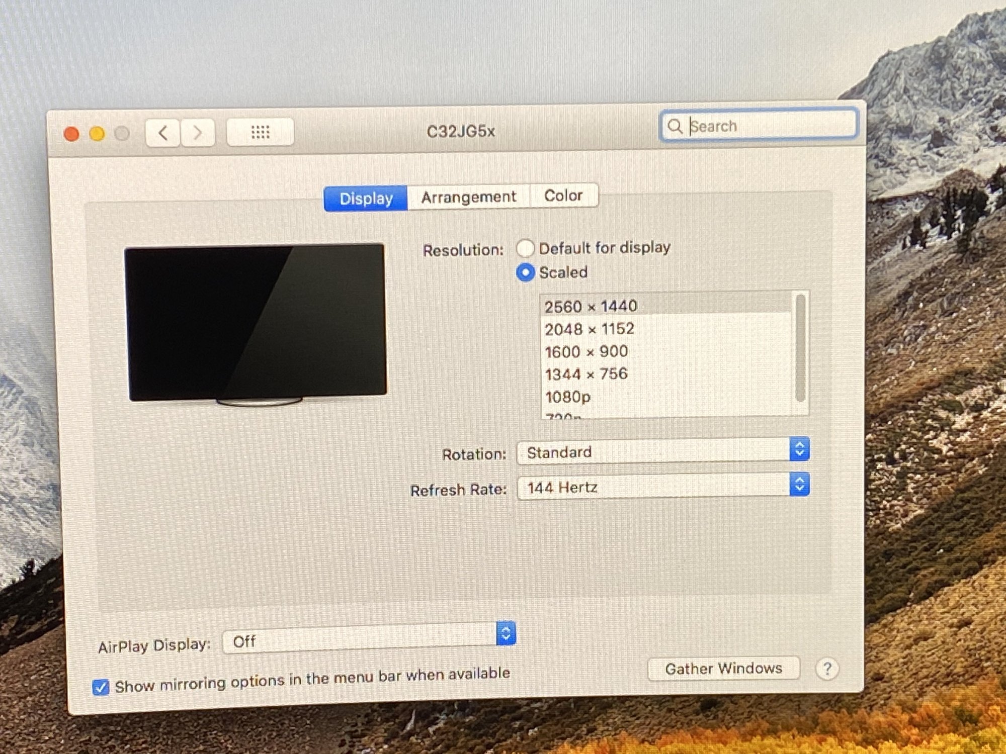

You are absolutely correct. Get this lol, so remember i put it in the windows pc and it didnt display then i plugged in both monitors and it did? Well i thought i wonder if i plug both monitors in on mac would the same happen. So i put it back in the mac, ensured all my commections were secure and swapped the 2 mini 6 pins round and plugged them into the opposite ones even tho i dont think it matters. Plugged in both monitors at the same time which i hadnt been doing on mac and as soon as i pressed the power button the fans spun up immediately and then the chime and a few seconds later the password screen. And bang were in. Im not sure if it was the 2 monitors, the swapping of the plugs or if being in the windows pc first kicked it into life. Ill try booting up with 1 display just to double check that and maybe swap the cable plugs back just to check that in case someone has the same issue and finds this
Reactions: ctrlzone
