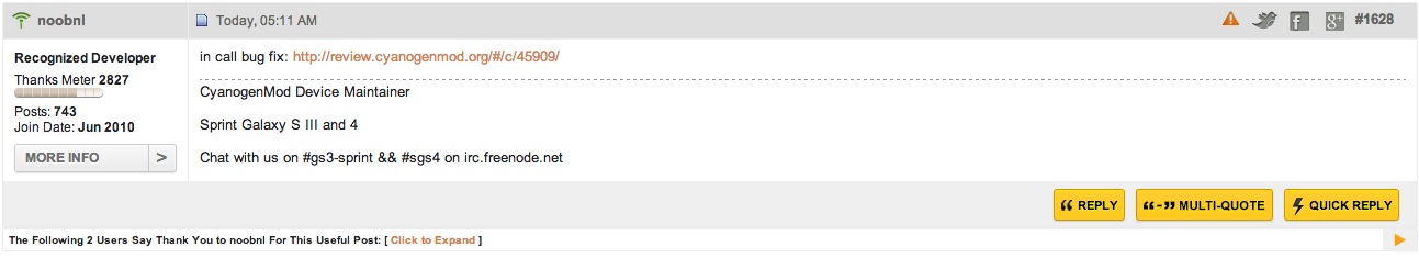

There's a lot more but I can't think of any because of how happy I am right now. One of the CM devs working on the S4 just said he found a fix for the no-sound in calls that you sometimes get in CM on the S4! The fix will be in the next nightly (23/7).
