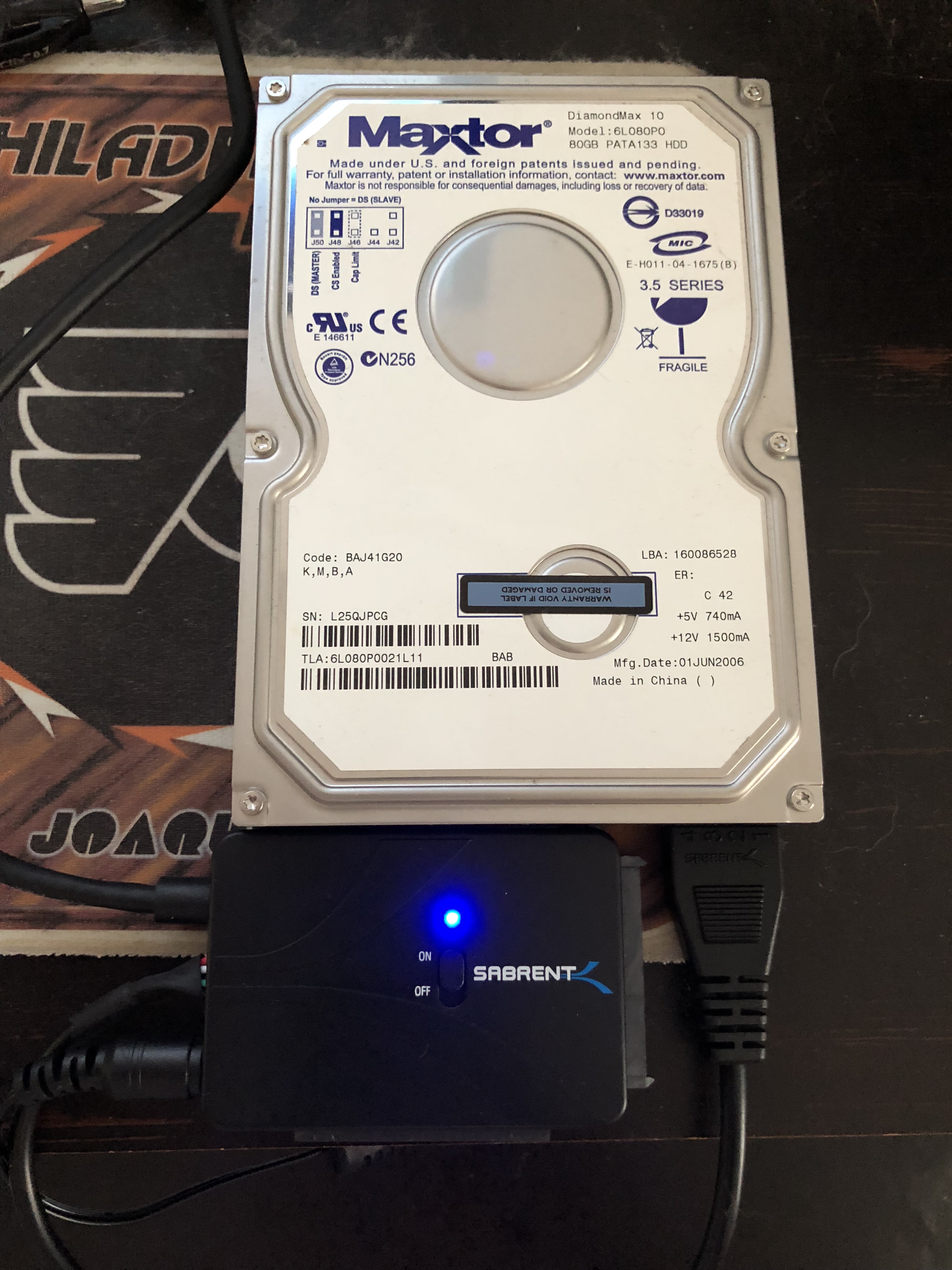

I received the Sabrent kit yesterday and tried it out last night on a WD drive I had from an old windows pc...as soon as I turned on the adapter, the drive spun up and my iMac recognized it immediately!
It was great, there was some old pictures on that drive that are now safely on my Mac!
I have another drive that I tried to access, a Maxtor, but it wasn’t happening. I think that one needs professional attention, it was making odd sounds. I even brought it to work today to see if it would maybe like a windows computer better, nope...same sound and actually changed to a clicking.

I had another old (Dell) pc under my workbench that I took the hard drives out of this morning and one of the drives is a Maxtor. I hooked it up to the Sabrent adapter, turned it on...it spun right up and was instantly recognized.
I removed all the pics from it and saved them to my desktop!
Maybe your Maxtor has internal damage like my other one does?
